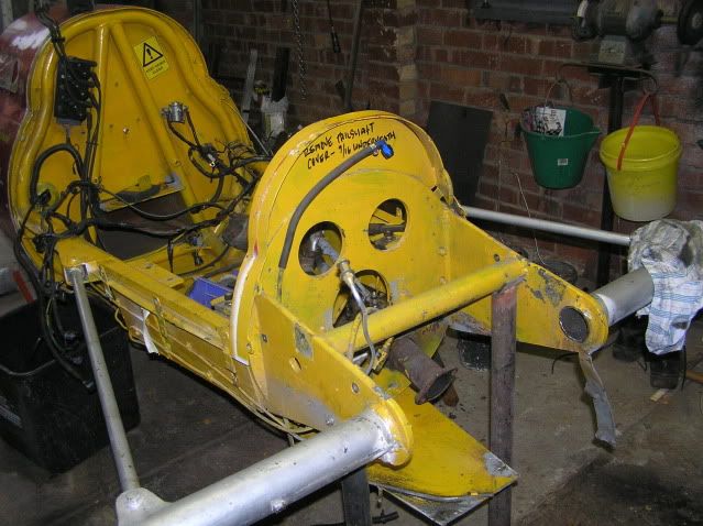

Today I changed tack, the earthworks on the rear of the Spirit of Sunshine for the new diff need to begin. As the year progresses there is a gradual decline in the motivation to embark on the big jobs...I figured if it went on long enough we wouldn't start this job because there might be a risk it would not be finished in time. The car won't be going to the lake next year unless we finish the job because as of this afternoon there is no pumpkin left, I chopped it out.
I removed the axles, the brakes and backing plates as one piece and some of the braces that hold the rear floor. I moved the axle stands to a cross-member inside the rear superstructure and took off the pyramid brace for the chute mount. Then I cut the axle tubes just inside the rear legs that hold them. My idea is to have some tube machined as a sliding fit in the original Ford axle tubes and then the other end ( slightly smaller, the whole lot will slide back into the orig' tubes to fit it up))machined to be a hot fit in the ten bolt housing. At this point we haven't looked too closely as to whether there is any difference in the crown wheel line that might mean we have to  have axles made or change the arrangement of the rear superstructure because there isn't much room for the pumpkin to move far either way. We have 28 spline axles that would fit the original diff, we're hoping we can use this new centre with them....I'm still getting my head around what we have to measure and do with those measurements.....There will also be a difference in pinion height ...we only have two inches of tube in our tailshaft.

Now you have some space, and a saw
Do you think you could cut a hole in that plate so you could get those exhaust link pipes out
« Reply #1777 on: May 01, 2011, 07:44:23 AM »
 :-o now that is committment!!!!!
« Reply #1778 on: May 01, 2011, 12:07:50 PM »
Or a reason to BE committed.
Nothing flinched when you cut out the pumpkin?
My idea is to have some tube machined as a sliding fit in the original Ford axle tubes and then the other end (slightly smaller, the whole lot will slide back into the orig' tubes to fit it up) machined to be a hot fit in the ten bolt housing.
Gosh, maybe I'm just lazy, but you have it torn down this far.  And what you have here is so simple in its design.  I've got to believe replacing to whole housing and re-fabricating the attachment points would be preferable to creating what will be, in the end, a 5 piece axle housing.
No it all sat there pretty relaxed.
The car was built on a pretty tight jig and measured up pretty well. We want to keep the Ford axles tubes and I'm not so confident that I think we can nail it as accurately, that is the alignment of the axle tubes.
Worse case scenario we have to build another jig and start from scratch with another rear end housing. That's a little more money and work than it sounds... If this works the way I'm hoping it will have saved a lot of grief.
If it doesn't work we haven't gone in the wrong direction, the old diff had to be cut out, it has no useful hangers anymore so either way it was to be butchered......if we can pull it off this way we'll be at the salt next year ready to rock.

Being a bike guy, I am having a hard time figgering out what you are doing.  The pumpkin is the differential, it seems.  That looked like one of the better parts on the tank.  What is happening to it?
« Reply #1782 on: May 02, 2011, 01:43:40 AM »
We are changing the diff from a Borg warner 8&3/4 (2.77:1)to a GM 7&1/2 10 bolt diff.( ratios from 2.73:1 up) However we wish to use Ford axles. We are attempting to change the centre section of the third member.That will allow us to achieve both, it mighten't work, if it does it will save a lot of grief in the alignment and keeping things straight while welding stakes that is the primary reason for avoiding a wholesale swap out which from the outside would seem a lot easier, more practical and above all , sensible.
The alignment of the rear axles and pumpkin is not as critical in a car that does about 40 miles a year as it would be on a taxi or a daily driver. I think it will work with some custom bits made up so as it can bolt up. The plan is in my head and it's hard to transfer it to paper.
After seeing a guy I worked for modify a borg warner 8.75 to fit in a Datsun 240Z this should be easy.
WW.
Goggles is calling the bit in the middle, the actual differential part in the housing, the pumpkin.
