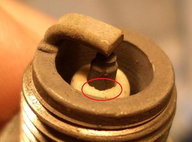

There's been a couple of slightly conflicting links posted here, on how to 'read' spark plugs
but what'ta'your'think:
To me it kind'a OK
...Color change , more or less in the middle of ground strap
( plug heat range OK )
...grey/brown'ish color at the point where inner-wall meets porcelain
( indicating jetting/mixture is OK )
...base ring and inner wall grey-black
( indicating mixture is OK )
UNclear indications of tiiiiny spots of aluminum on ground strap.
Tiny black spots on porcelain
Deteriorated porcelain .
...that can't be good . Sign of pre-ignition ?

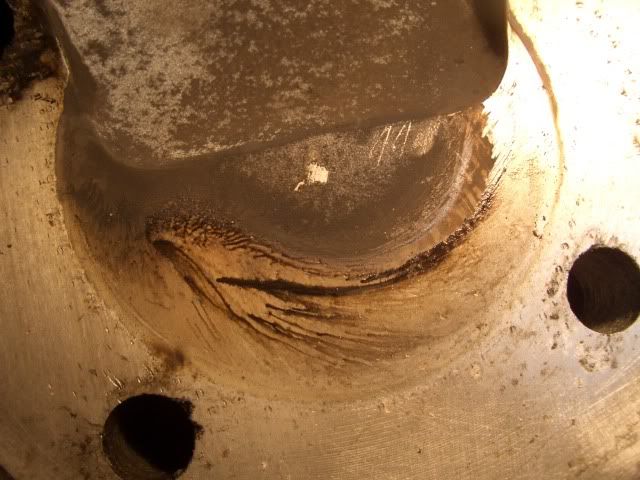

THIS worries me:
Weird oil-stain on piston...???
( The polished part is because I wanted to check if there was any evidence of
pitting  ( aluminum deterioration causes by pre-ignition ) ...but there was none )
Similar weird oil-stain on corresponding head:
What IS that ???

 Howdy Lars,  The ONLY way you can get a valid plug reading is to clutch and kill the engine simultaneously while it is at full speed.. Any other way is a exercise in futility.. Kinda like pissing into the wind.. That black stuff could be oil that worked its way past the rings, REMEMBER you did not beak in the engine  and the engine tolerances were set up on the "loose' side.  The black stuff could also be excessive fuel that was not burned completely, could be slightly gooey and tacky. Didn't you say in your build sheet you were thinking  about running alcohol?? Did you? If you ran gas your plugs will look 1 way but if it is alcohol  they will look differant than gas..1 thing else you are tuning a 50 year +or - old technology that means you have to use "back in the day" knowledge and experience. You know, Fred Flintstone stuff.. Did you get my last PM>?  Take it easy, Mike R.

In the lower left side of the piston picture it appears that the edge of the piston is damaged. Is this just an optical illusion in the picture or is it actual damage? It appears that the swirl stain originates at that point, so possibly you have damaged rings in that area allowing oil to bypass them into the combustion chamber.
Are this picture and the plug with the deteriorated porcelain from the cylinder that cut a groove in the head when the gasket failed? If so they may both be collateral damage from the gasket failure due to the groove allowing outside air to be sucked into the cylinder and leaning out the effective mixture, along with the corresponding loss of compression, and completely messing up the burn characteristics. If so I wouldn't worry about those too much, just focus on fixing the root cause of the failure.

  Lars,  Whizzbang KC is definitely correct about the piston.. The plug is showing gray and porcelain is showing pre or beginning detonation.. The lip of the piston looks to be eroded away. Is there any scoring on the cylinder wall where the top is eroded away? Good job, Whizzer,  Mike

...and surfaced them in the manner I've always used.
Thick sheet of glass...working my way through finer and finer grades of abrasive paper
that I spray-glue to the glass, using first water then thin oil on the finer grades,
sanding in a circular motion
Ahhhh. Lars, after you get the groove from the blown gasket welded up, take those heads to a good machinist and have them properly surfaced with a fly cutter.
I'll bet you a beer at the Black and White next year that surfacing them the way you did left them "not perfectly flat". The thin areas between the combustion chamber and the bolt holes would tend to be sanded down ever so slightly more than the thicker areas due to the way the paper and lose abrasive behave when doing it that way.
I used to use that method myself on H-D Shovelheads, then one day I checked one with a machinist's straight edge and saw that the "flat" gasket surfaces actually tapered off just a bit on the edges. Less than .002 inch, but still enough to not properly clamp the gasket. That was the last time I used that method.
You can check yours with a good straight edge across the chamber in an area that wasn't damaged by the failure. You shouldn't be able to see any light between the edge and the gasket surface, all the way to the chamber. Should be a nice sharp edge on the sealing face.
Ah, this is obviously some strange usage of the word 'safe' that I wasn't previously aware of.  Douglas Adams

Lars, the machining leaves a slightly rough surface which helps retain the gasket especially when it's a fibre one. This will probably help as well with the existing gasket, although I'd rather still see a solid copper one.
