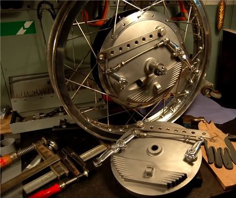

Also I've mounted a set of Tomeselli double-jointed clip-on so I can
adjust the position of the handlebars in any way I bloody please.
( On the pic they are mounted with a single-joint)
I haven't a clue why I haven't done it till now.
The front wheel as of now it 'stolen' from my BSA build,
cause during test-riding it's probably a good idea to be able to brake the darn thing
and I might need front brakes to run SCTA. ( I'll find out when the rule-book arrives.)
I recently rebuild it with new bearings and re-spoke'ed / re-laced it (?), etc.
and the tire is brand new.
It's a helluva good looking front wheel/brake don't you think ?!
Dual action double-sided Grimeca. Yummy!

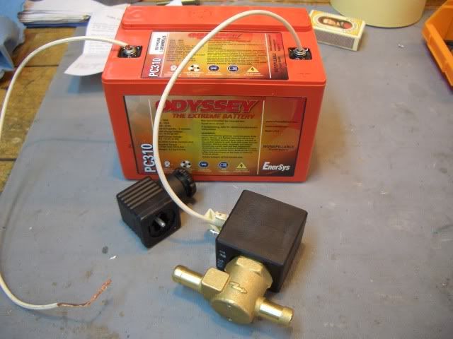

the remote fuel-valve arrived from the UK
and I'm trying to figure where to mount it.
