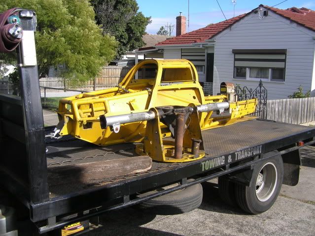

 Got the carcass onto the back of the truck...
You may also notice those short pieces of exhaust....for the last five years they have remained captive in that rear bulkhead. I think it is just because they annoyed the Colonel so much that I was disinclined to change it......today I cut the bulkhead so they can be removed.......now they can be covered in that shiney sh1t while the rest of the frame is to be blasted....a lot of the frame still had mill scale on it so the paint will stick a lot better this time around, as I said earlier I was surprised how little rust there was.

You need to cover all the holes in the diff to limit the garnet ingress
« Reply #2688 on: June 16, 2012, 03:17:26 AM »
why?
Is it abrasive? :-o
hi Stew,
that nashua gaffer tape would do the trick,
i've used it on some things i've had blasted lately,
best thing you've ever pit me on to.
Benno. 8-)

Duct tape works well to cover things you dont want blasted.
« Reply #2693 on: June 17, 2012, 05:39:34 PM »
It might be a bit late, because , hopefully, Goggs is in his truck on the way to the Blast Factory as I write this
I find Nashua Gaffer the best thin for sandblasting, and i buy my Gaffer Tape from the sandblaster.
Once you've used gaff tape, you'll never want to even look at a roll of duct tape.
Leaves no sticky mess - especially if it sits in the hot sun and the adhesive gets soft.
3-M is about $20.00 a roll here - and worth every penny.
