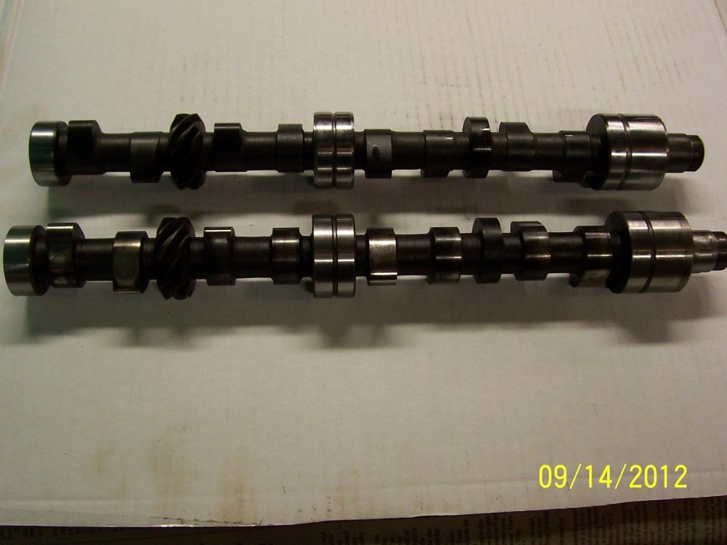

As promised photo of "non-lawn sprinkler" cams.  BOTH are steel cams.  Upper cam is a KC595 ground on a KC blank; lower cam is a stock "spyder" drive 1275 cam ground on a BLMC blank.  NO extra oiling holes on either camshaft.........
It continues to be my opinion that wear problems with steel cams are a result of improper cam/lifter "break-in" procedures and/or incompatible material specifications.  (Refer to my previous post, edit:[reply #1168 on page 78] ,in Midget's Build Diary regarding this subject.)  There is so much oil "raining" off the rotating masses inside the crankcase at typical racing speeds, the issue is not lack of lubrication (except at very low rpm's) the issue is one of controling the amount of oil in the crankcase.  This is why dry sumped engines typically pickup horsepower.  (er, ponypower, for BMC's)  You don't want your crank assembly to be a high rpm butter churn......    Leave a crankcase cover off or crankcase plug out and rev your engine to peak rpm if you don't believe this to be true.

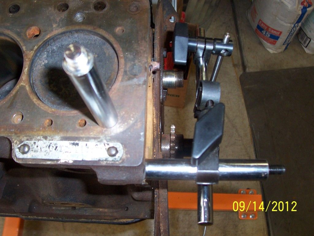

WE DON'T GOT TO SHOW YOU NO STINKIN' BENT WIRE CAM TIMING POINTER!!!
Midget, et all,
Since a picture is still worth well over a thousand words, cogitate on these:
Next time you suspect you bent the flimsy bent wire pointer you have been using to time your cam(s), whip up a set-up based on this idea.  This sturdy setup will preserve (not if you are a racer already) your sanity...............

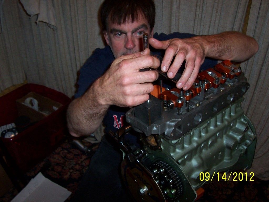

               Cam timing setup in situ:                                                            Engine elf busily tinkering away.........
               Engine elf continues to tinker............                            Engine elf finds myriad of uses for precision measuring devices
Note the obligatory ration of PBR......Some elves simply cannot be enticed to perform labor without rations, go figure.......
Good afternoon & evening, bunches accomplished my friend.  Hope you learned a few new things.  (Like 1/4 - coarse thread bolts can be handy sometimes........................., even on a veddy Briddish car.)
