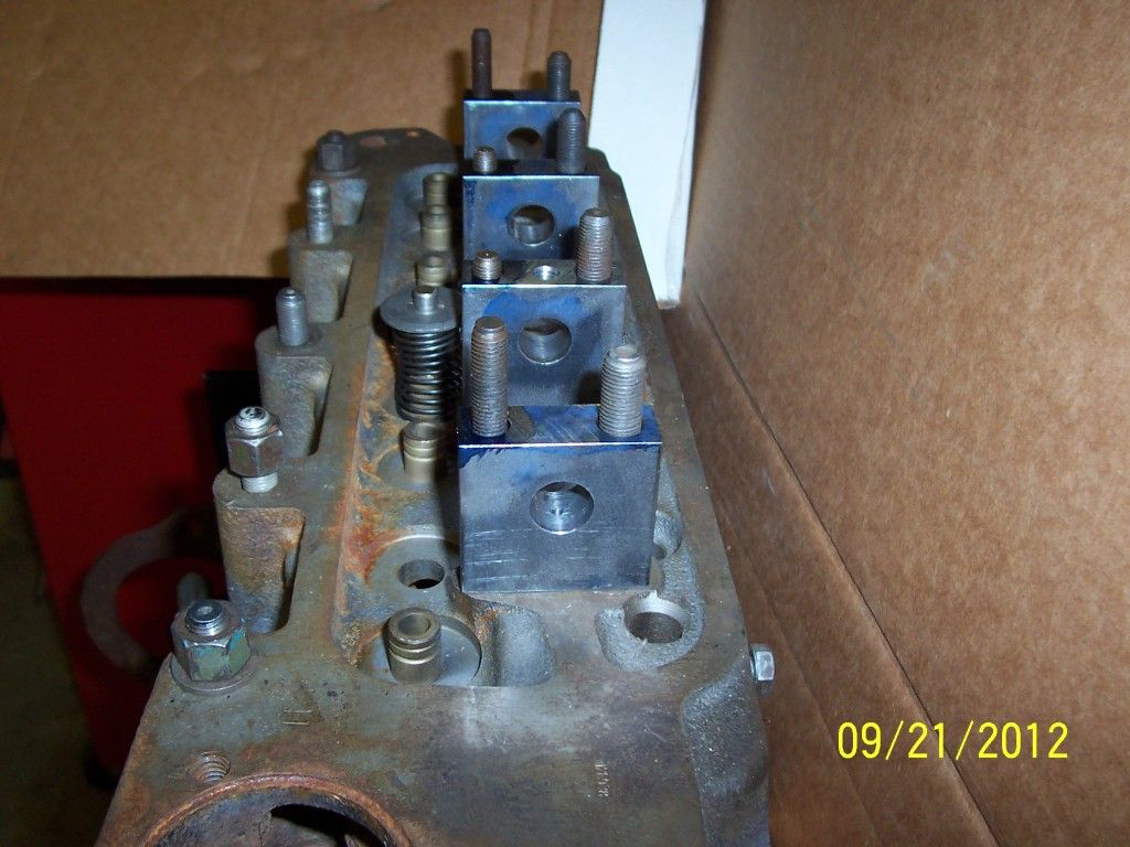

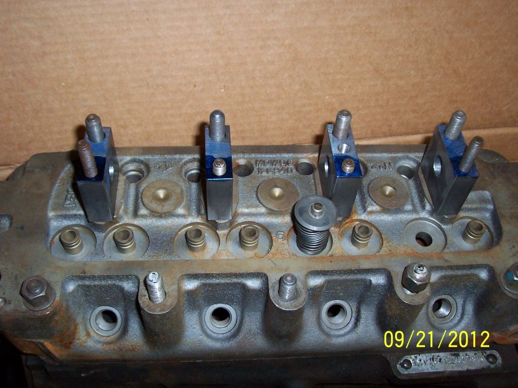

WE DON'T GOT TO SHOW YOU NO STINKIN' ALLOY ROCKER PILLARS...........
Midget,
For the Evolution deniers out there:  Documentation of Evolution....................
Still have to do some relief cuts and/or grinding.  Expect them to be fully evolved TODAY.....
Even the simple requires time to evolve though.......................

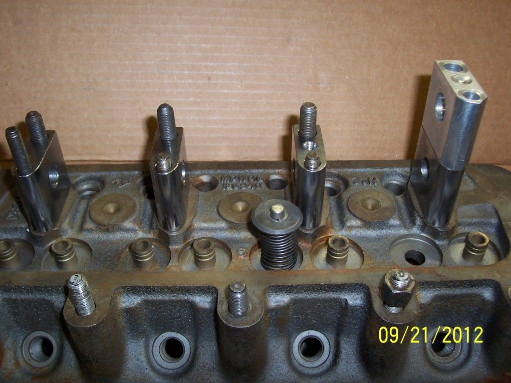

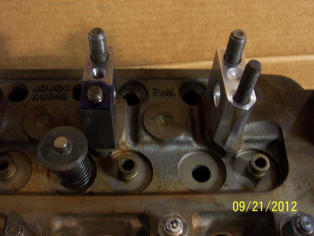

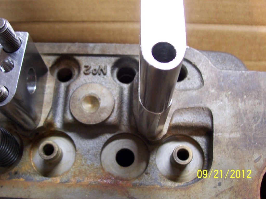

FINISHED ROCKER PILLAR PORN!!!
Midget,
Photos of finished steel rocker pillars, note differences between pillar types on valve spring side.......    I'm hopeful that there will not be any clearance problems between the pillars & the rockers throughout the lift range........
Completed evolution....  compare the photos above to the ones below from my previous post, reply #1564.

Wow - the chops of a jeweler.  Gorgeous!

Thanks for the jeweler comment, but I just tumble-peened them.  Hardens the surface a bit, deburrs 'em & makes 'em look nice.  Absolutely no effort on my part, except to load 'em in the machine and turn it on.  It's nice to have access to the machinery though.  May I humbly suggest you do something nice for the Apex crew??  (List them as a sponsor??  Or pizza/soda/beer or other food/drink maybe..........)
