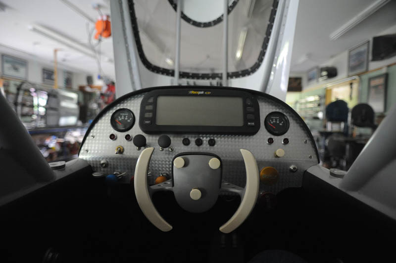

Here's the url for today's post:
http://www.target550.com/gallery/190_instrument_panel_bling/index.html
And here are a coupla extra images for your viewing pleasure:

Is there an interlock to prevent the canopy from opening at speed?
I picture reaching for the chutes or fire bottles in an emergency and opening the canopy.

I think the canopy has a manual release only at the rear of it. It has to be able to be opened outside by the emergency crews. The air cylinders are for lift assist and to keep it open.
« Reply #1594 on: September 21, 2012, 10:27:32 PM »
Just above the drivers head is a short lever that pulls the pin out of the hole in the roll bar.
It can be opened from inside or outside. The duct that lets some air into the cockpit has
the outside release at the top of it.

Freud -- here is what you are looking for.  It's just aft of the NACA duct in the canopy overhead.  You can see the inside handle -- as well as outside handle flush with bodywork.
