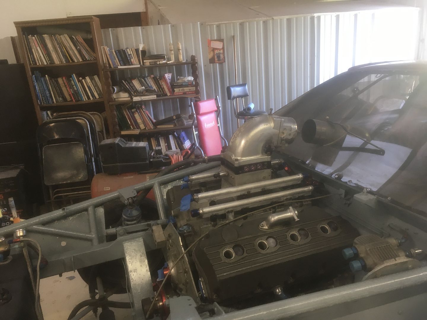

  Troy painted the engine bay and trans covers Sat and i worked on a timing pointer and polishing fuel rails.
  Met with Steve Moody today going over EFI stuff . need to order 160 lb injectors, an injector driver module,and make up
a couple of injector looms.

Sorry I'm a little behind on the photos.  I'll try and catch up here.
120lb injectors on the bottom and 160s on top.
More fresh paint and we mounted our new Holley Dominator EFI.
Clutch installed and adjusting the fingers, what a pain!!

Today we got a few things done.  We got the ballistic blankets over the transmissions so tomorrow we will button up the tunnel covers.
We cleaned up the blower tubes and will install those tomorrow as well.  We got our headers back and they look great!

 Also trans covers were installed and a little touch up paint.
 Checked that transmissions were shifting [triggered by 3 toggle switches on steering wheel]
