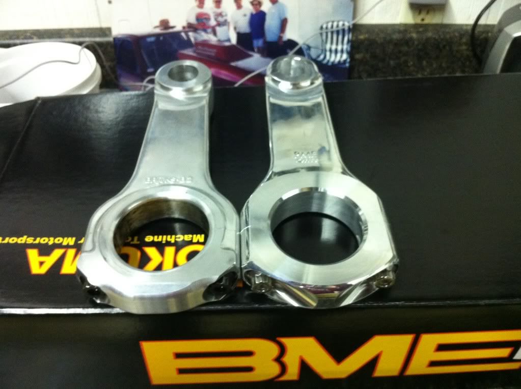

  Decided on Bill Miller Engineering top fuel rods as they have a stronger aluminum metal developed for aero industry
and forged out of billet plate instead of just machined from plate. Sent 1 of our Brooks [out of business] rods to him
as he thought he might be able to machine some weight out of his top fuel rods.
 Also sent a piston to look at problem and see what he recommends. But we want 81/2 compression, annodized like his top fuel pistons and dykes ring.

« Reply #1418 on: March 19, 2011, 01:34:12 PM »
Some parts are in!!
The BME rods is on the right, thicker in some places but hard to see.
Anodized BME piston
You can see the difference in thickness on the bottom oil ring.
On this photo you can see that the BME piston is much thicker at the skirt, and the skirt is a little bit longer.
We will be putting one piston in to check to make sure it doesn't hit the head, then take the rest of the engine apart.  Today is a new beginning.

I'm sure BME are quality rods but I wonder why you chose aluminum rods? Top Fuel places huge stresses on the rods but only for a VERY short time. Aluminum has a far shorter fatigue life than steel rods. Top Fuel guys throw the aluminum rods away after a few runs.
REgards, Neil   Tucson, AZ
Offline bvillercr
  • Posts: 2293
Re: Getting ready for Bonneville(rebuild)
« Reply #1422 on: March 19, 2011, 08:36:20 PM »
Niel, the main reason is that there is less shock.  Secondly they weight less and cost less.  Top fuelers have 8k plus HP and big bucks to throw them away after 8 runs.   The billet aluminum rods that we have been using were never the problem, but when we lost a piston it torched the rod.  Now Brooks rods is out of business, so now we went with BME. :cheers:
  • Posts: 4160
« Reply #1423 on: March 19, 2011, 11:47:50 PM »
Thanks for the explanation. I'd Zyglo them for cracks every once in a while, though.
Regards, Neil   Tucson, AZ
