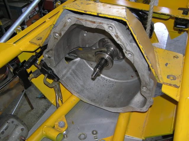

Minor freakout just now, seemed like my calcs may have been wrong and there wasn't enough room for the tailshaft with the existing gearbox cross-member mounts......that would have junked my last few days of toil because it would have meant remaking the tailshaft..... crisis averted , I've got it sitting in place . I've just chased out the threads in the bell-housing, nothing like hi-grade cheesium for good quality threads :roll:
Hey Colonel, tell me one of those bolts in the back of the gearbox was put there as a joke....yes the one that seemed to have a 3/8 UNC thread but a "tween-size" head???????Anyway, they're all new in there now.
Next job set-up the bellhousing, throw out and slave cylinder just to make sure everythings there, serviceable and ready to fit up.... I wish I'd gone to bed earlier last night.........

The Colonel dropped the box and bell-housing off yesterday so I could get started fitting up the shift and the tail-shaft.It also meant I could fit the clutch line...I had a bit of trouble stopping the fitting at the base of the master cylinder from leaking, (lower right in pic)
it seems I just hadn't done it up tight enough..after that it all pressurized up fine, those welding vice-grips are just right for holding the slave cylinder while I bleed it....
I sat the scatter-shield on top of the bell-housing so you can see how it goes together there.....
when you have to make one of these special construction things there are place where you have to find something that will work before you make what you will use, the prototype. Sometimes the prototype doesn't get replaced, our shift mechanism on the gearbox is a perfect example...it's a mongrelised, jerry built bastard of an arrangement.
 I have several ideas that would work well, but in the mean time it has to stay, soon, it will be replaced...The main problem we faced was that the shift cables could only approach around the bellhousing, so the shift needed to be extended outwards in order to make it work...note there is no other path for the shift mechanism,it's about building it with finer tolerances.
The idea for the gearbox means making a faceplate to hang off the shift side of the box to give a greater bearing area for the shafts that extend out, then they can be supported at the outside end with a bearing, that should make for a much more snickworthy shift. It was a relief that when I hooked the cables up ( after them being removed from the car by being cut) they seemed to shift AOK on the weekend.
Something else I did on the weekend was re-route the clutch line....... In this shot obviously the collector passes through where the vice-grips are, now the clutch line avoids this area by going to the outside of the scatter shield and heading in from the top.
