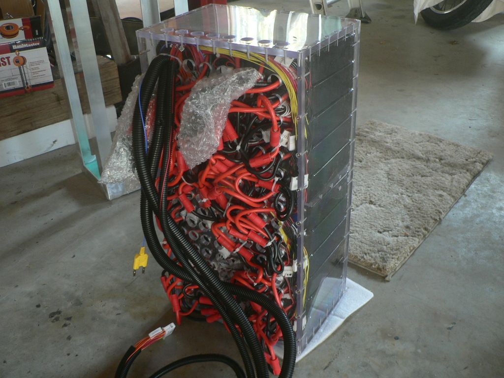

Thanks.  I've taken a few rides, trying to make sure I haven't missed anything major.  It'll be a screamer!  I took a couple of low-power rides to exercise the batteries a bit.  I then cranked up the motor controller settings and just got back from a 10-mile loop.  Fun stuff!  It weighs in about 550# although it feels lighter than my gas 'Busa.  I love the EV grin!
Speaking of batteries, here's a couple of shots of the new pack.  Back: (one cell near top right shifted a bit during transport.)
This is a 540kW pack (700+HP) even though the setup in this bike will never use more than 1/3 of that.  I've been drag racing another electric bike this year and have plans for this pack in another machine.
Front (you think there was a lot of wires in that other pic?):
We decided to keep the main power connection wires outside the box for cooling.  This application doesn't really need much cooling but a drag machine will.  The exposed wires wick heat away from the cells.
« Last Edit: November 10, 2015, 05:31:03 PM by Frank06 »
