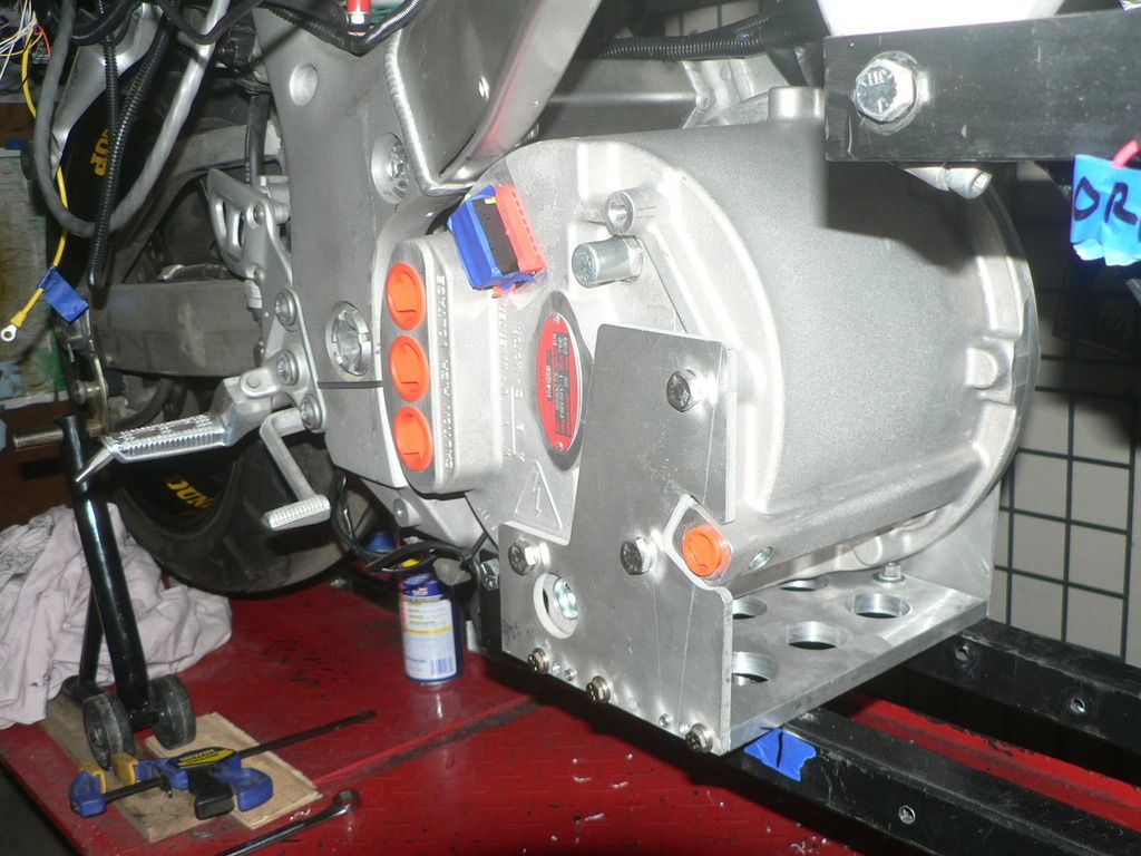

« Reply #39 on: October 13, 2015, 07:10:59 PM »
Here's a shot of the new motor bolted down.  I had the new mounts (one on each end) waterjet cut out of .25" 6061 aluminum instead of the 1/4" steel plate used in the original build.  You can see the piece of 1/2" 6061 plate I used to support the motor mounts.  I drilled and tapped some 1/4-20 holes directly in this plate and bolted the sides down with grade 8 bolts.  You can also see some high-strength roll pins I used as dowels.  The whole rig sets on 1-1/2" square tubing I used in the original build, both to provide places to mount stuff and also to simulate the rigidity of the original engine.
