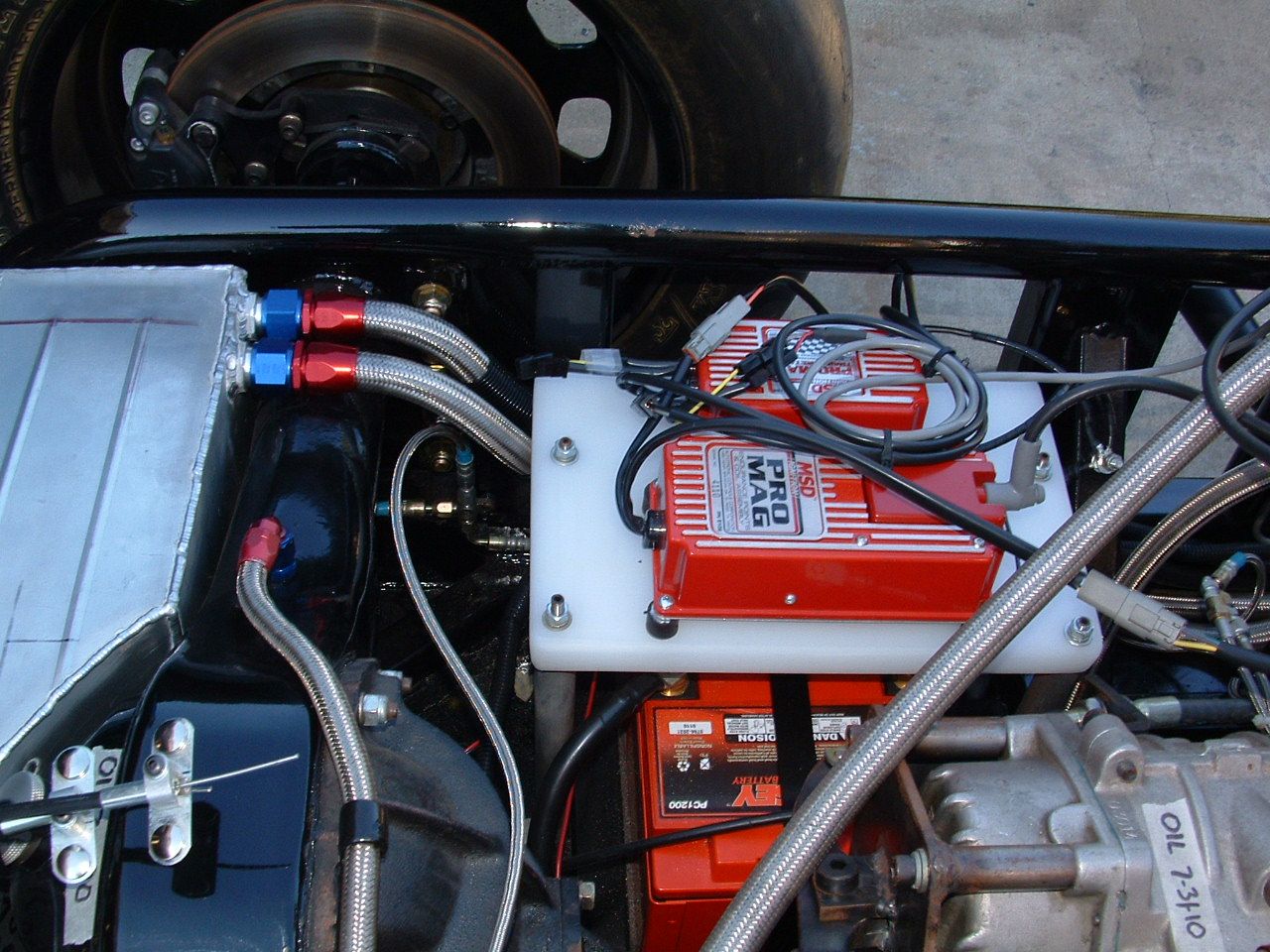

Ah, for instance, here's a nice close up and a few others, again of which some might be dupes:
And here's a photo of the culprit that's responsible for the car (I think this is Anthony):

What type of tranmission is that. I'm sure I should know but I don't.
Thanks Rick
219.648 mph F/BFMR 2010 Record
4 cylinder Esslinger
Could of had a V8
Offline anthony young
  • Jr. Member
  • Posts: 46
Re: Anthony Young's C/FRMR
« Reply #19 on: January 19, 2011, 09:09:41 PM »
quick change 2 speed  doug nash
  Anthony ...does Doug Nash make a bigger input shaft than the stock chev. We twisted one and twisted the replacement in two. Thats when we went to the Owens with overdrive and bigger shaft. We never had a problem otherwise. The gears looked brand new with no metal in oil and no problem with quick change gears,
  • Jr. Member
  • Posts: 46
« Reply #26 on: January 20, 2011, 03:10:22 AM »
i do not know for sure, but i dought that this style of trans comes with a larger dia shaft, i bought this trans from john rank , he used it in his modified he went to a 4 or 5 speed i know that everything was coated incl the gears. the first time that i have an issue with this trans i will put a lenco or owens most likely an owens ,lets see if it will pull a gear under a load ,also we can always make a larger dia shaft we will see  thanks anthony
  Owens might be able to make a bigger shaft if you have problems, its nice to have the quick change gears to get the gearing
above 2.5 to 1. and what ever gearing you need. One Owens unit [2 speed] with overdrive measures 13''  front of case to bearing support end + 31/2'' output shaft which can be shortened. If you need a spare doug nash, I have one with a shortened input shaft :-D
  Also the Owens overdrive doesn't shift its always in overdrive.
