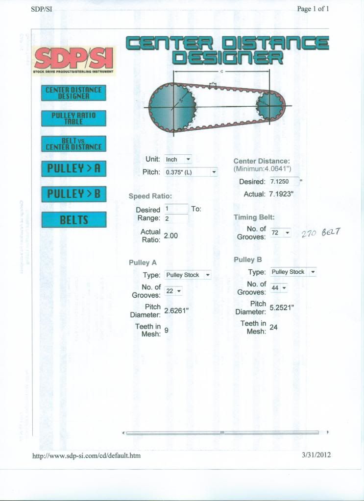

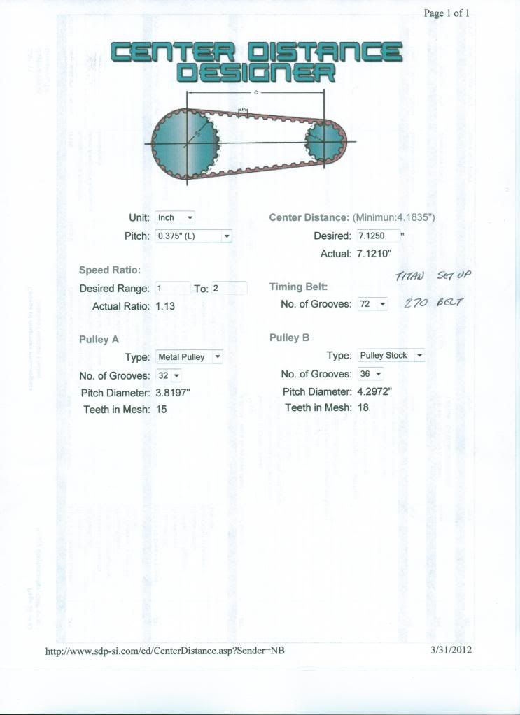

« Reply #1056 on: April 08, 2012, 07:12:45 PM »
Midget,
Some of the possibilities for gilmer belt water pump drive using .375" pitch x .50" width:
Still exploring possibilities on .200" pitch x .50" width.
Happy Easter,
