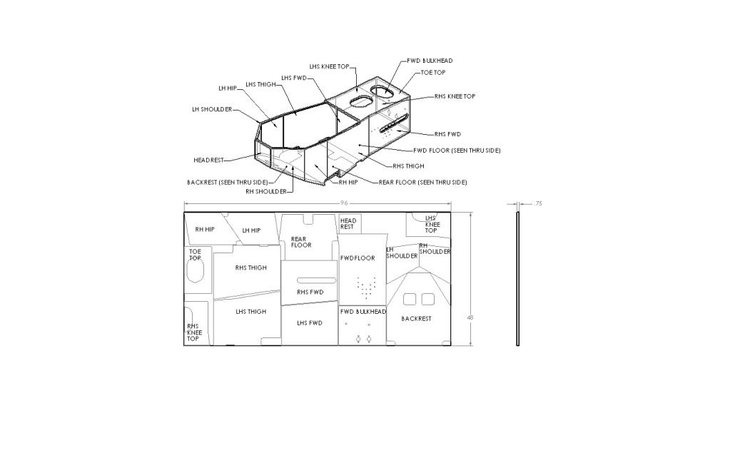

Anyone have a good source for honeycomb panel on the west coast or know someone with some scrap panels or surplus. I need it to fabricate my tub for the REMR. I need it to be at least .025" skin and more than 3/8" core density. Thicker skin and denser core (say 1/4" cell) is even better. Aluminum, fiberglass, or nomex core will do. Tony
Scrap or surplus may mean defects. Have you done strength calculations? There is a huge difference in tensile strength and shear strength between the cores you mentioned. You didn't mention the face material, and that also has a great deal to do with strength. Aluminum face? What alloy? Fiberglass? 2 ply, 4 ply? Even at a 1/4" cell, 5052 aluminum core with .004 wall is 5 times stronger than 1/4" cell, 5052 aluminum core with .001 wall.

Dean, We want the aluminum face in any available alloy at least .025" thick.  If we were going to have to form the edges on the skin the alloy would matter and in this case even the softest skin alloy  (probably 5052-H32) is fine. There are sometimes much stiffer skins available, but they are actually slightly less preferable in our case. The reason the core can be not-the strongest is because of the way we are using it. It's not a structural member, it's a container where it's meant to give (in a nice manner) if your body-slams it in a tumble.  My preference would be the .004" alum core, but the softer core would work fine- just dent easier. 3/8" cell is getting a little too coarse unless it's pretty thick  (.007"+) cell wall.  Thinking about it a little more I'd rather pass on the nomex core unless it's pretty fine.
Peel strength is also not an issue here, nor is bending. About the only thing that can get too weak here is the skin thickness- then the fastening points would be insufficient unless you use a zillion of them.  The basic design is to keep the driver safe from objects protruding in and hitting the body and also to be able to take the load of the body and give when tumbling.  It’s not going to be a feather bed, but it’s going to be a lot better than hitting a pipe or a stiff panel. Also it needs to be able to come out in parts for cleaning.   My friend Steve who designed the tub has over 25 years in designing tubs for some of the top teams in IMSA and CART and feels this is a safety necessity for us, as we want to try and interject some science and take out much of the relying on luck playing a roll in a crash.  In the next few days I will try and update with better drawings of the tub in my build diary. Tony
