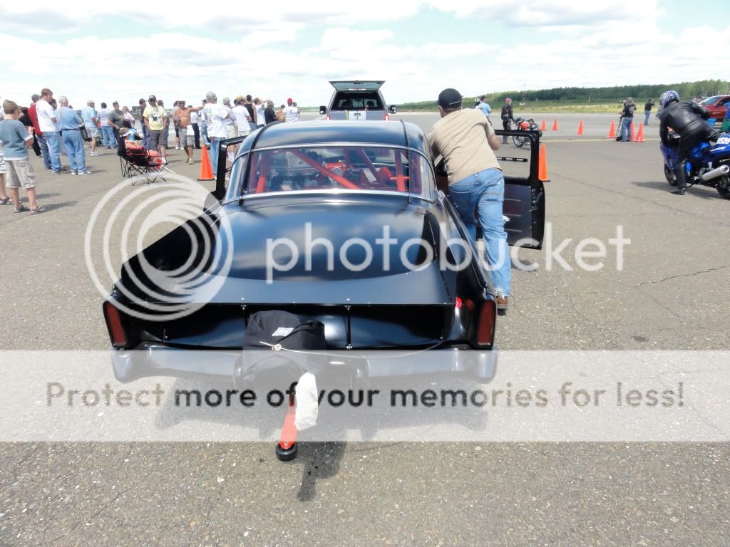

I think my side plates are to narrow (mounted to open with the trunk). I have a design from Hooley's 974 Stude and his are as far to the outside as can be, I may have to make entire new spoiler and side plates for Bonneville.
What I have works so far on pavement/concrete .
Here is a rear view (the chute deploys and acts well, so it must be in good air ??) I do have a video of that if you want to see and advise ?  The side plates could be relocated to the outside about 3" and mounted to the body.. or maybe I could leave this as is and just "add" a second set of side plates to the outside of these (making these more like jumbo diffusers??)
