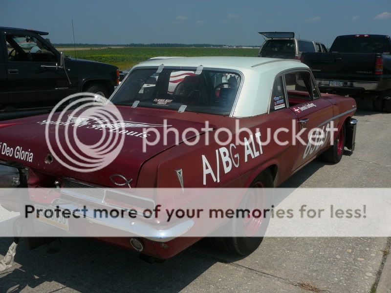

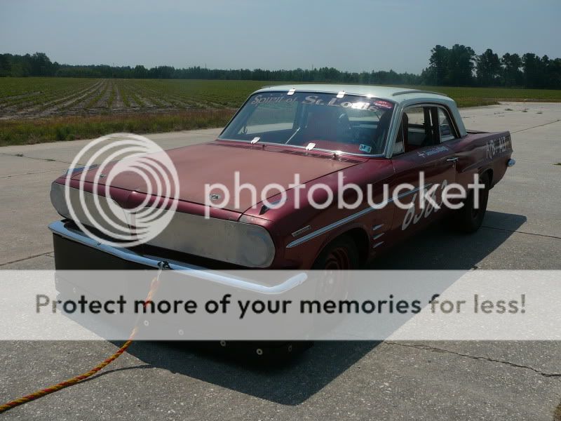

I'm thinking about putting a pushbar on my twin turboed LeMans for next year's Speedweek.
We were only able to get our Lakester up to 60mph before the first set of cones with my wife's Denali which by the way, I'm still cleaning. LOL
If I could give him a 120mph push, I'm sure we could put 40 or 50 mph on our 2-1/4 speed. It was only 247.
I would probably have to add some ballast to the rear to get the traction but everything else should be stout enough to do the job
