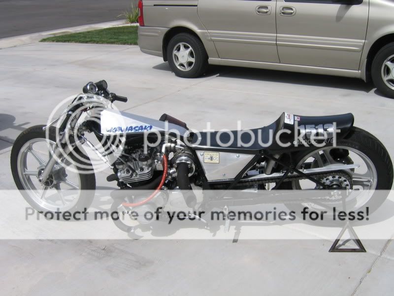

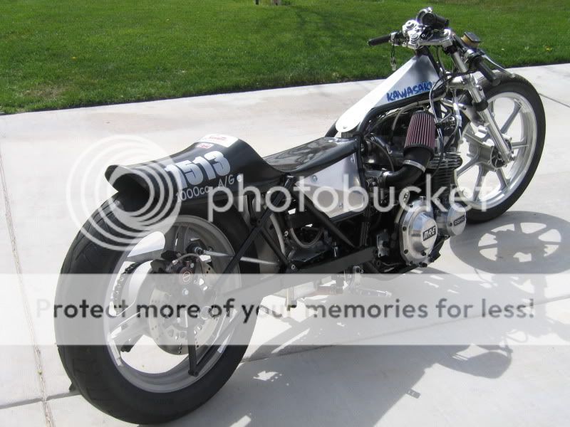

Well I’m another step closer to being ready for the May meet at El Mirage.  The bike is finished, the new turbo engine runs, the tranny shifts and all seems right with the world!
I just need to do some tuning on the high side of the S&S Super B carb (that should be fun---NOT), change the class numbers to 1350 cc A/BF and then take her out for the maiden voyage (around the block).
I’m anticipating some issues with tuning the S&S as I’ve never worked on, or ran, an S&S carb and I’ve never build or ran a turbo engine, so this is all new to me.  I’m glad I’ve got some extra time to fiddle with this setup before the event in May (I just hope I don’t hurt the engine while I’m trying to get it setup)……..
 A couple of shots of the finished bike……
Looking forward to seeing everyone in May….
Buzz

The bike looks great......except for that aircleaner......we ran almost the same cleaner including the elbow
.....would not pass enough air at full bore......We used a KZ Kawa with the same Turbo set-up as yours, at 10lbs boost........get another air-cleaner set-up........................................................................
bak189,
I really appreciate your input and candor. The air cleaner has been a source of problems since I decided to run the turbo.  I felt the cleaner I came up with was too small but my plan (and don't shoot me) is to run the bike in May and make an initial pass or two and see how the bike runs.  If I feel the bike would run better, with better intake air flow I'll make a couple of passes without the air cleaner (gulp). If I get my 1000cc normally aspirated engine completed by mid-June This turbo engine is coming out of the bike and going on the shelf so I'm not too worried about hurting it.
I f I decide to run the turbo for more than one meet then I'll see if I can come up with a better (read bigger) air cleaner.
Thanks again for the advice.
Buzz

I'll need to pay close attention to my left leg John  undecided.  I'm going back and forth on whether or to wrap the exhaust.  There a little more clearance than appears in the photos but I know the exhaust is going to get hot.....fast!
