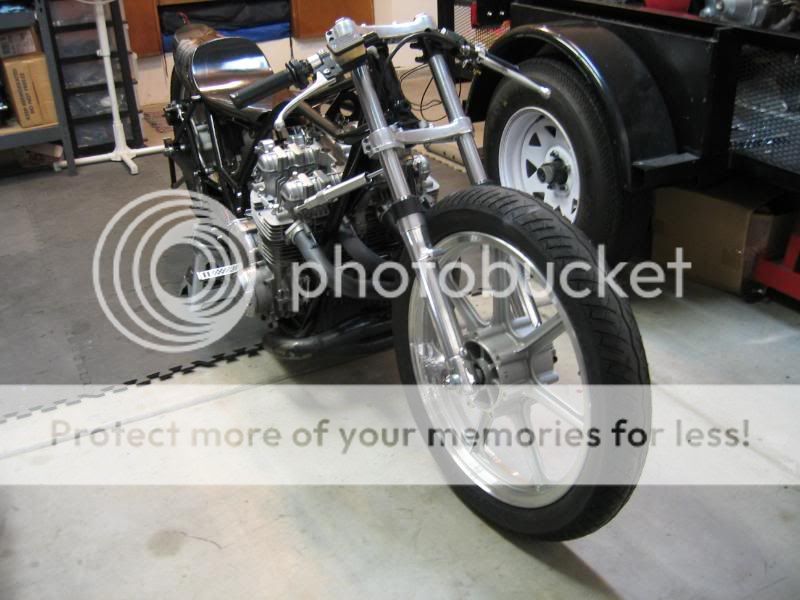

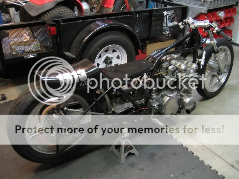

 undecided  Allnighters is right....Last Saturday and Sunday were killers but a lot was accomplished.
Fabricated the chain guard, installed the exhaust system (had to try three different systems before I found one that will work), Installed the carbs, got the throttle cables made and installed and tested the fuel pump to make sure it won't siphone with the power off and the bike on it's side.  Got the rest of the safety issues addressed and had to chase parts for most of Saturday afternoon.
Alway the small missing parts (AN fittings, fuel line and etc) that seem to take the most time.
The fuel system is completed and working ( I was a little worried that the pump might overpower the float seats but nope, it works great...1.5 lbs of unregulated pressure.
All that's left to do, on the bike, is the wiring and install the braided rear brake line & bleed the brake.
Then I remembered that I have to have a CB (and get it installed) and buy a trailer hitch and get it installed on my new tow vehicle (Well not really a new tow vehicle, but new to me).
So even if it doesn't sound like much I'm sure I'll be working many hours next Saturday and Sunday if I'm going to stand a chance of making El Mirage the 14th.
Then I have to hope I read all the rules and the bike will pass tech!!!
Header almost completely installed.
Chain guard completed and ready to go....
Almost ready....wiring and rear brake left to do!!
