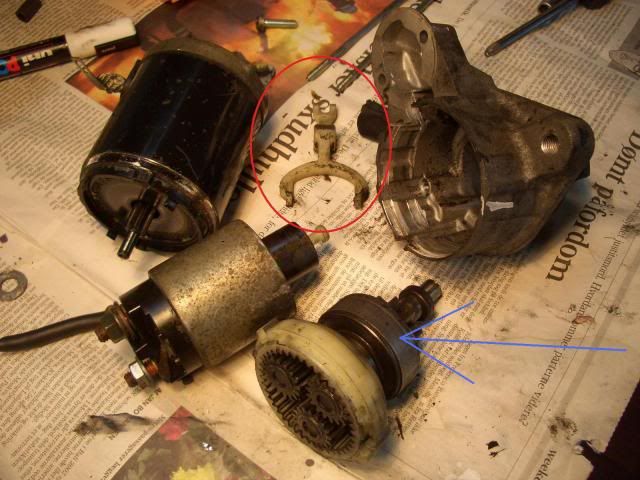

Got the parts ready for the roller-starter:
...One piece of scrap aluminum
...Two pieces of POM Delrin
bought cheaply from the local plastic whole sale dealers cut-off-pieces heap.
It's an amazing material.
The rollers will be shaved 'smooth' at each end,
and stuck directly into corrosponding holes in the Delrin , which can easily
act as 'bearings' for the rollers on each side.
...One Mitsubishi starter from the auto junk yard
Took the starter to pieces to remove the 'arm' from the solenoid to the cog-wheel
..as the starter will be connected directly:   cog-wheel--axle-->roller,
and as the bike starts, the cog-wheel will run for a short while freely ( not dragging the starter-motor)
by means of the over-running clutch ( blue arrow ) on which the cogwheel is attached.
More on all that later.

Mostly because that would require some sort of transmission/reduction-gear between the starter and the drive,
to get enough torque / lower RPM from the cheapo car-starter.
Too complicated for a simple guy like me.
