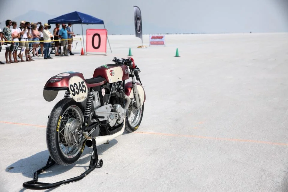

« Reply #39 on: December 15, 2018, 10:39:37 AM »
old GSX750 wheels. got two of them:
the front will go in with just spacers.
17 x 3.00 inches. goodyear says their 2.5-inch frontrunners will fit just fine.

« Reply #40 on: December 15, 2018, 01:06:11 PM »
That's a good find! Those spokes look like good aero. And being able to use an actual LSR tire is a plus.
