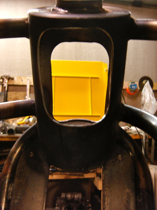

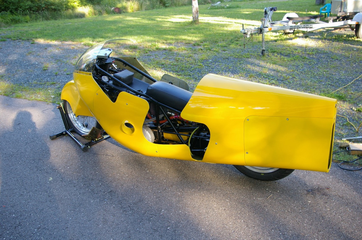

You make that tank pad as thick and soft as possible.  If I did not have them (on three record holding bikes), I would not be able to hold my head up. Like this:
« Last Edit: April 19, 2019, 08:42:13 PM by Koncretekid »

I'm no biker, so this may be a naive question: how do you see where you are going in the bottom picture?

I look thru the front window! This is the same bike as the fully faired version above on which I do the same thing.

From the side view it looks like the top of the helmet prevents you seeing forwards over the tank. Depends where your eyes are I suppose. Don't tell me, they are on the front of your head (just below the eyebrows) like everyone else.  8-)  :roll:

The other advantage of the tank pad, with your helmet strapped on tightly (which is the only safe way), is that the pad forces your helmet up just enough to allow maximum forward vision thru the upper extremity of the eye port in the helmet. I believe that Shoei is now making a helmet for racing with a higher eye port just for this reason.
