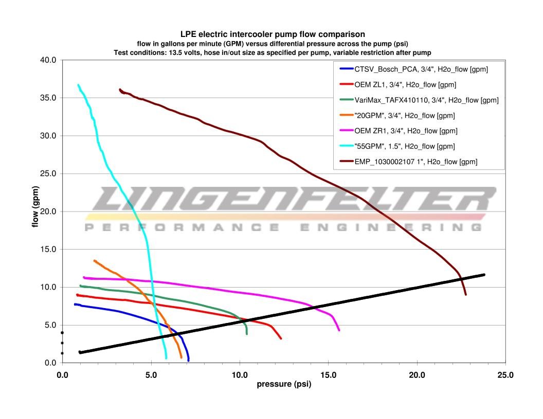

Lingenfelter's test results on electric pumps .
http://www.caddyinfo.com/cadillacs/Intercooler%20pump%20flow%20vs%20pressure%20drop%20graph%20WM%20with%20pump%20curve%20estimate.jpg
