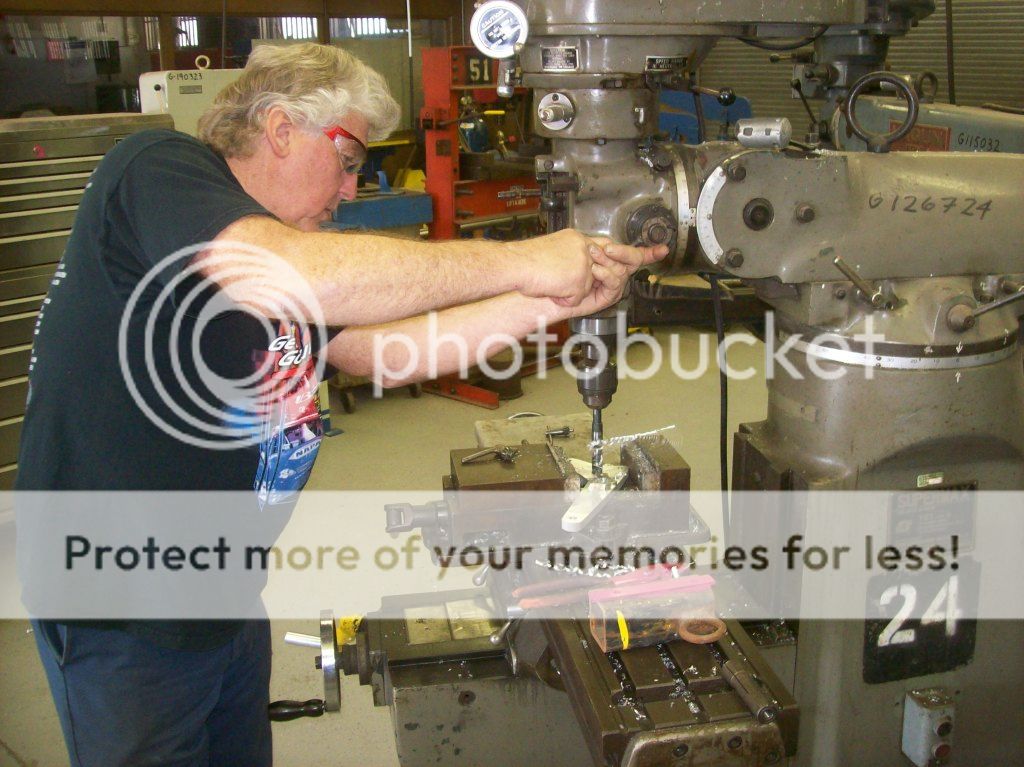

Jacob has been busy fabricating parts. He's been helped by Warren Marlay,
"MR. MARLAY" is the metal shop teacher at Monta Vista High School.
Warren Marlay modifing the new pegs . No one makes parts for the CX Honda so everything has to be made or parts for other bikes have to be modified.
Working side by side on the mills, Jacob & Warren were getting it done between classes. I don't know what was deeper....The metal chips on the floor or the OLD SHOP TEACHER HORROR STORIES
Jacob fabricating new peg mounts to get the rides feet back on the bike.

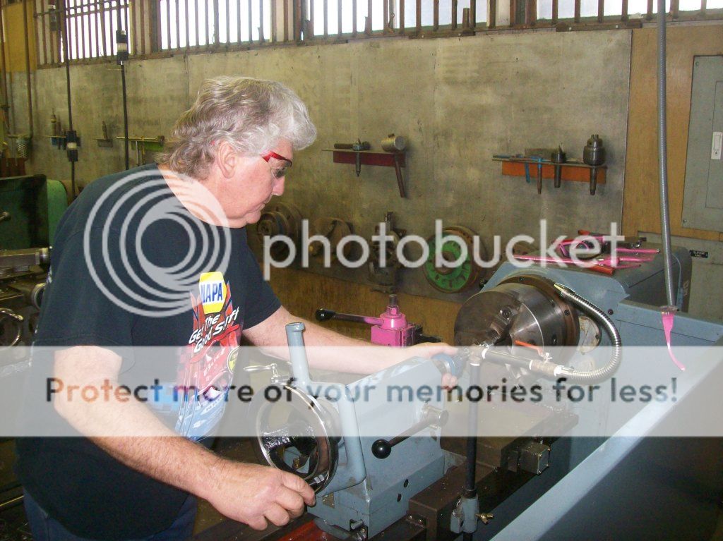

Jacob switches gears & fires up the lathe. When I asked what he was working on all he had time said was SPACERS....Then the bell rang & the metal shop students started flooding into the shop.

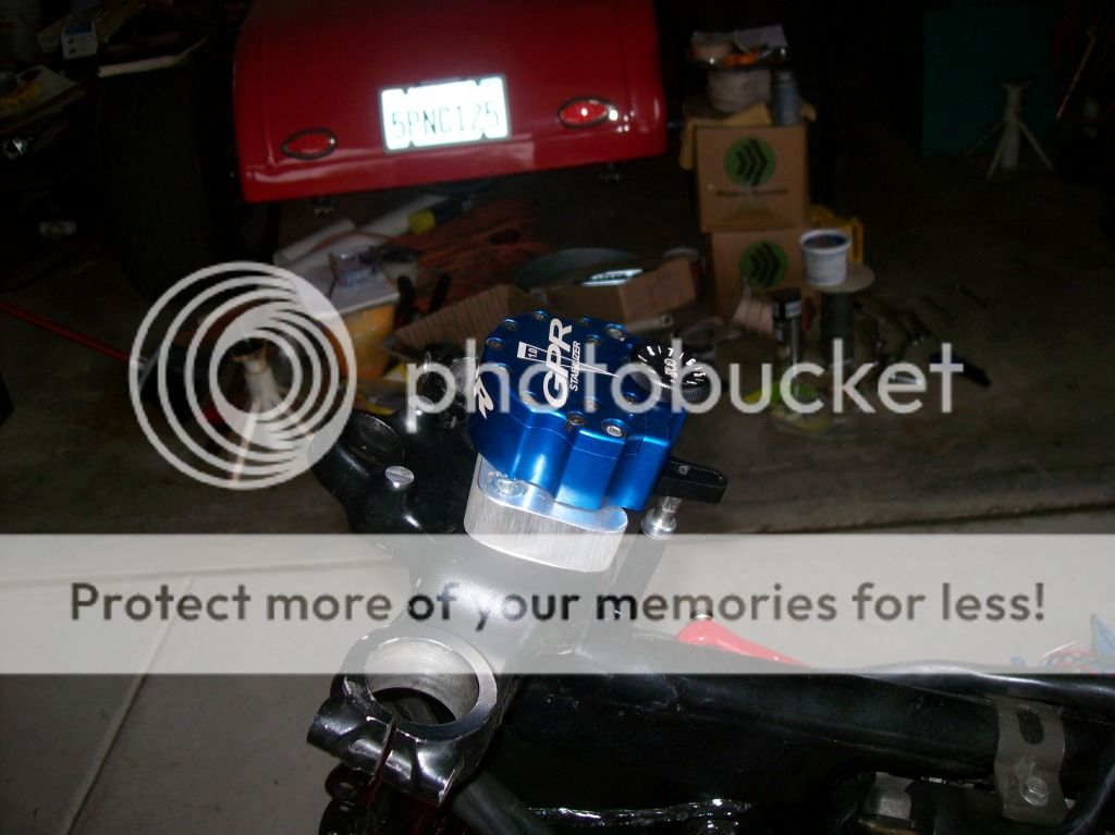

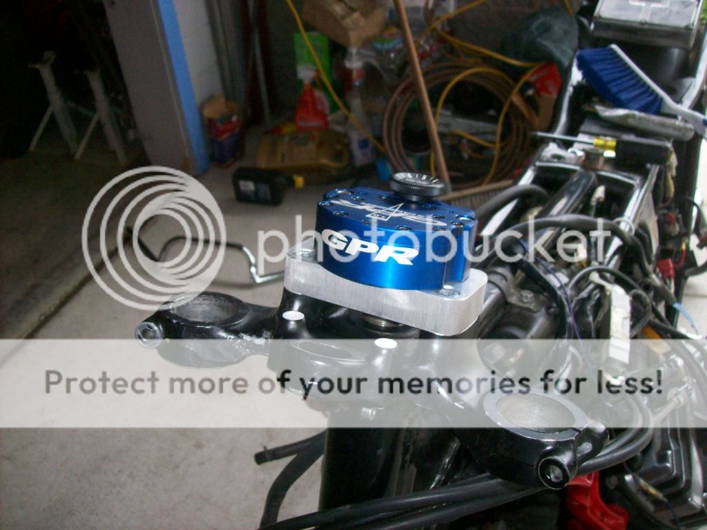

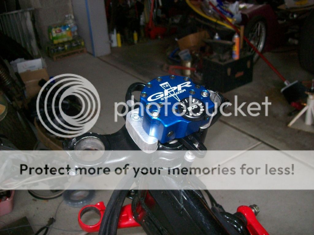

Jacob had to modify the top of the triple tree to get the GPR stabilizer mounted
Bar mounts were milled off & mounting block was fabricated.
Little finish work & the block will go to be anodized & top triple clamp will go to powder coat
