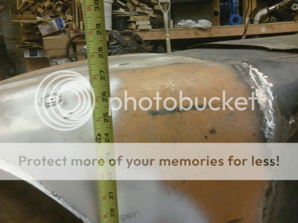

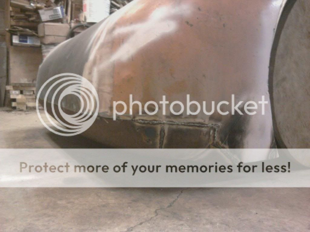

So here it is!  Or most of it, still needs some small things like a hump over the valve cover and a hole for the intake, but its "dry" now with its roof on it.
As you've probably noticed, I have changed the front end design alittle bit, should be alittle more slippery now!  Especially with the belly pan which isn't visible, but it is there.

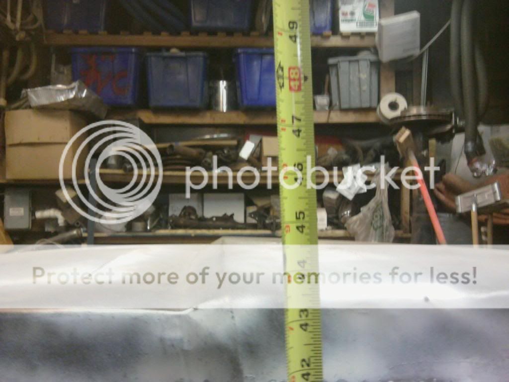

And this is the final ride height of the Model T, the front...
The rear...
