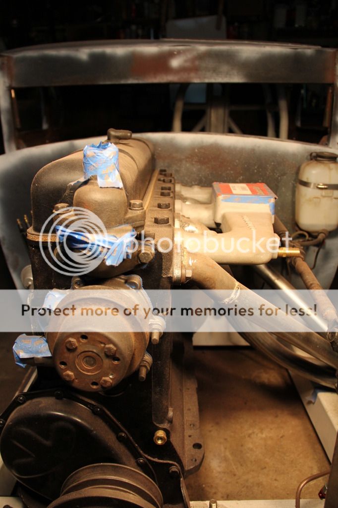

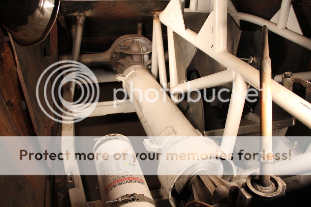

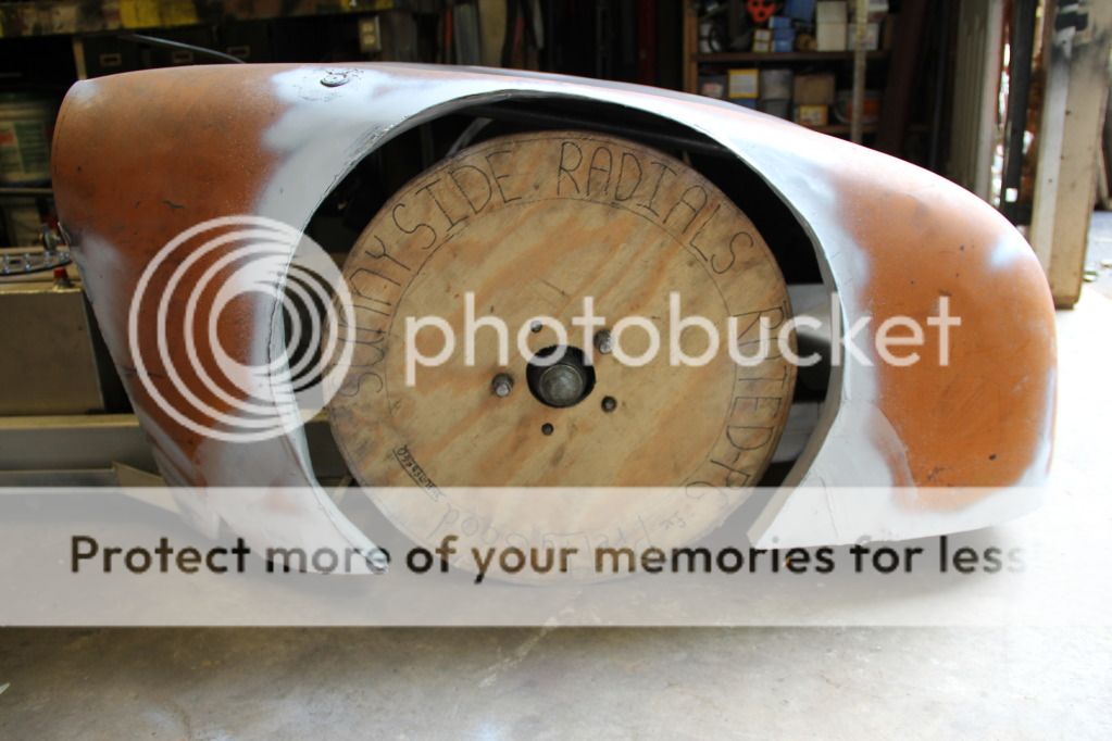

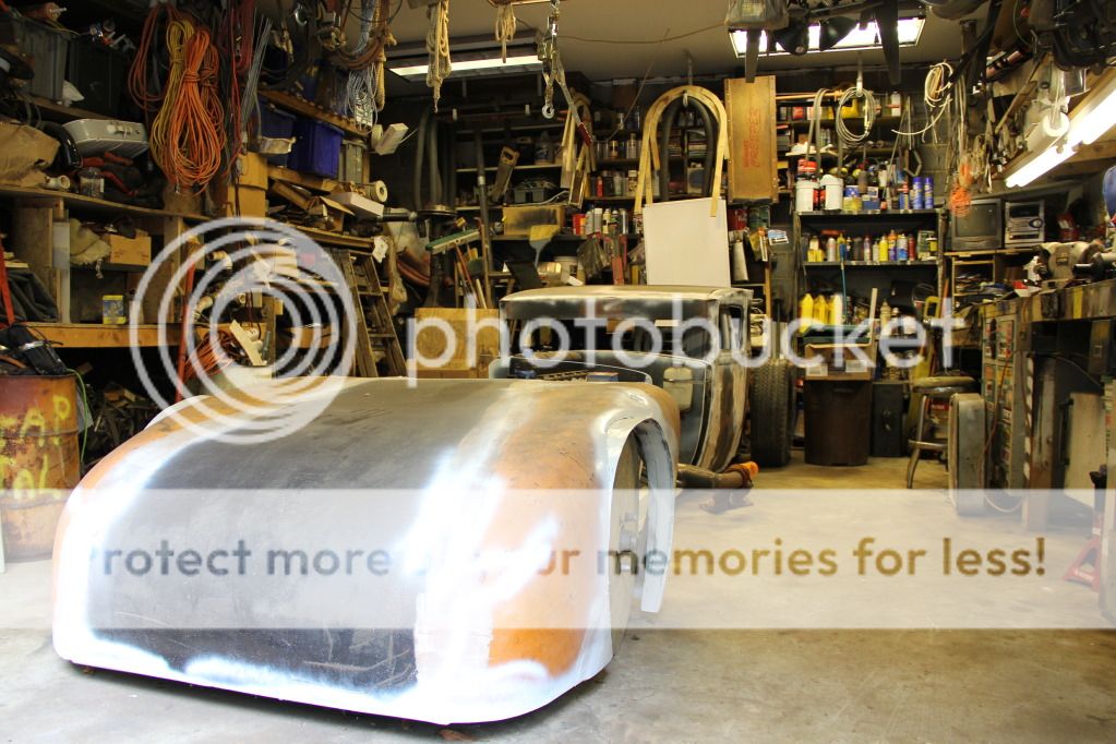

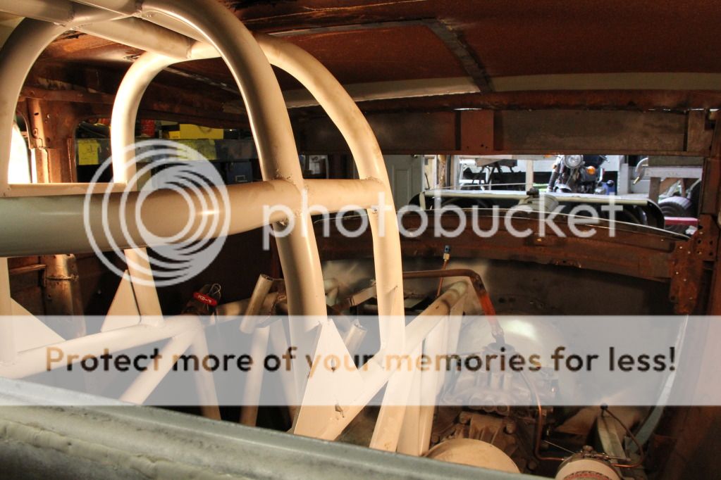

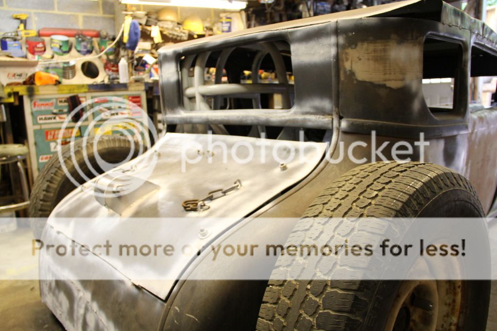

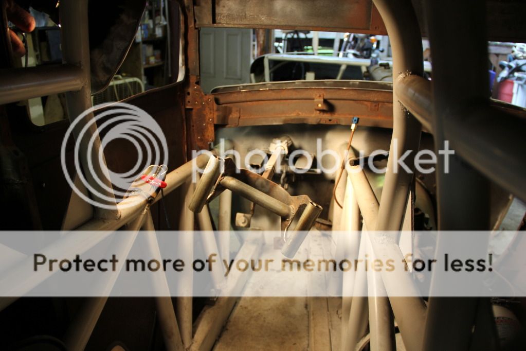

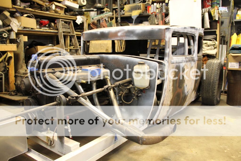

An article about my build you say?  Fame and fortune you say?  Money and beautiful women you say?  Ok, perhaps I am dreaming a bit, but I think most of us wouldn't be on the forum if we didn't dream.  grin
Well, hopefully this is what you are looking for.
I got my boss's camera and took a few shots, started off alright, pretty standard shots...
Then all of a sudden I started taking some artistic liberties...
And here's one of myself and the shop for good measure.  It's not big and it's full of stuff, but some great projects have rolled out of there and I hope they will continue...
I hope those are big enough.  They are pretty big files.
Thanks,
Sam

Sam, it's a interesting project. Lots of hours of work. I will be glad to see it on the salt and see it run. Good job on the photos as well tells a lot on the build. cheers

Nice work, keep borrowing your boss's camera, cheers
remember to document the shots as you save them, sometime I look at the thousands of shots we have and think "WTF is that supposed to show....?"
Nice work, once again.

First, I want to say I really like this build! I love the vintage cars, with vintage engines-especially the ones like yours that aren't 'cookie cutter' builds.
I understand about artistic liberties, but your'e running a car with an engine that had high HP capabilities. Therefore, I wonder if you've really thought out that exhaust? It would be cool on a hot rod, but it looks like you would have room to get in inside of the frame rails, and run it where you can take advantage of it?

Thanks for the support everyone!  I keep chipping at it and doing little things here and there.  I am saving up money for the few bigger things that need to be done.  All that safety equipment isn't cheap.
38flattie - you are right that the exhaust could be built with more use of what is available.  It was done in as simple of a manner as possible for the current setup.  I referanced my old books, did some quick garage math and ended up with 28inch primaries being "optimum" before the collector.  If I end up with extra time and tubing, I'll follow Tom Burkland's suggestion of running the pipe back behind the rear window where the vacuum could help pull the exhaust out.
Dr. Goggles -  You are spot on about labeling every picture as what it is suppose to be.  All shots are saved as what they are supposed to be showing.  I work in the electronic media industry so I have developed a habbit of labeling all captured media as it is being loaded onto the computer.
