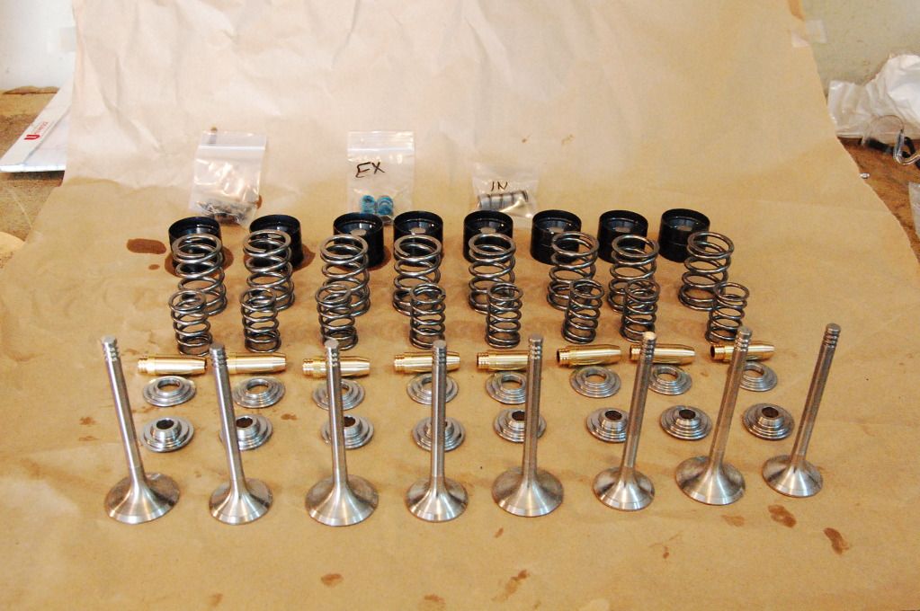

Valvetrain goodies.  Nothing too exotic, but nothing stock, either.

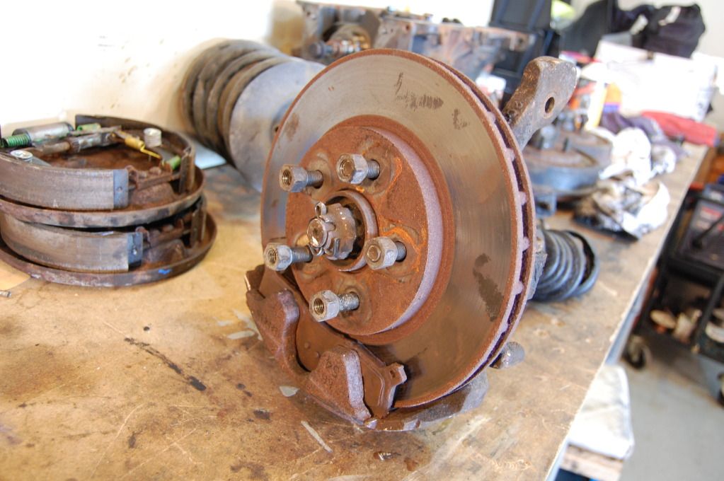

I managed to get to the local Pick-N-Pull junkyard for the 1/2 price sale this weekend.  I think I got all the suspension/brakes that I will need for the Rampage.  I was going for new front knuckles/hubs, struts/springs, and all new rear stub axles and brakes.

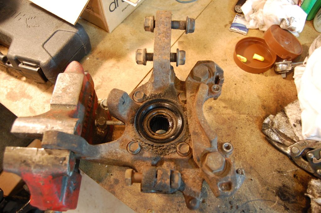

The reason for the swap-over from the stock rampage stuff if for several reasons...  By using later "K-Car" front knuckles and hubs, they will work like drop spindles compared to the Rampage knuckles.  The centerline of the drive axle is about 1" higher in relation to the lower ball joint.  The K-Car knuckles also use a bolt-in bearing carrier which is stronger and more reliable than the pressed-in bearings on the Rampage setup.  The K-cars also use a 5-lug on 100mm bolt pattern which will allow me to use 15" 5-lug wheels, instead of the 13" or 14" 4-lug Rampage configuration.  The brakes are also bigger, but I don't think that will be much of an issue for this Rampage.
I also grabbed some 1st generation Neon struts and springs, which will give a significant drop to the front end, and are a nearly bolt-in deal (just drill 1 extra hole in the upper fender where the strut mount attaches).  The 1st gen Neon will give the lowest ride height available from factory parts.  2nd gen Neon would be a bit higher, and the factory Rampage springs/struts sit higher than the 2nd gen Neon.  If the whole thing is too low (which I doubt), then I will change over to the 2nd gen Neon.
In the rear, I pulled the stub axles, backing plates, drums, bearings, etc. from a '90-something LeBaron.  Again, I get the bigger brakes and the 5-lug setup to match the front.
Here is one of the backing plates for the rear.  It must have been my lucky junkyard day, because it looks like these brakes have been recently rebuilt with a new hardware kit, wheel cylinder, and fresh shoes.
Front brakes, knuckles, and drive axles are from a '93 Plymouth Acclaim.  They are in decent usable condition, needing a good wire wheeling, bead blasting, and some fresh paint before being installed.
This is the "Hot" setup for L-bodies like the Rampage, Charger, Turismo, 024, etc.  These parts are much more heavy-duty than the stock L-body, and offer the improved geometry.  Here's a look at the back side of the Acclaim knuckles, showing the 4 bolts which retain the bearing and drive hub.   Since these photos were taken, I spent a couple of hours cleaning, degreasing, wire-wheeling, and generally de-griming these parts.  It was a hot, sticky, dirty, gritty weekend.

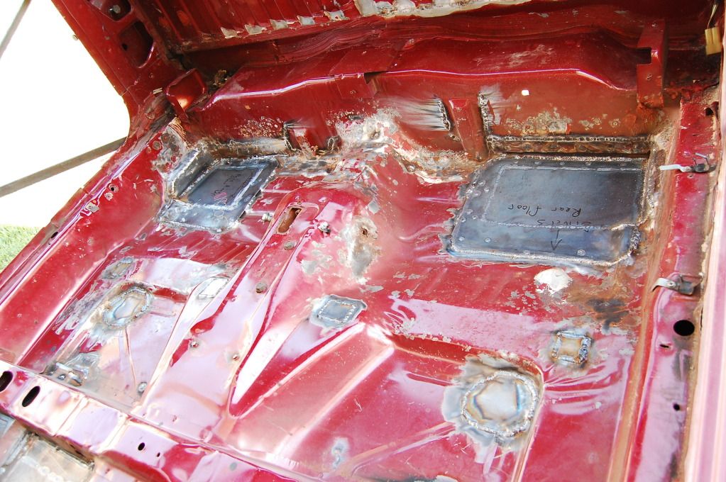

I finished welding in the floorpan sections where my little truck had rusted away.  There are no aftermarket floorpan patch panels available, and just about every Rampage in existence is rusted on the floorboards, I had to make my own, using flat sheets of 0.060" steel.  The overall contour of the floorpan patch panels is as close to factory as I could make them, but I did not have a way to roll in the "beads" that are present in the factory pans.  Seeing the work done on Gkabbt's Rampage has humbled me.  In order to re-create those two stamped in beads, I think I'm going to have to split some round tubing and weld it to the underside, in order to match the factory profile, with the humps and bumps.

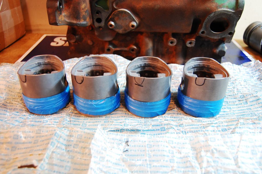

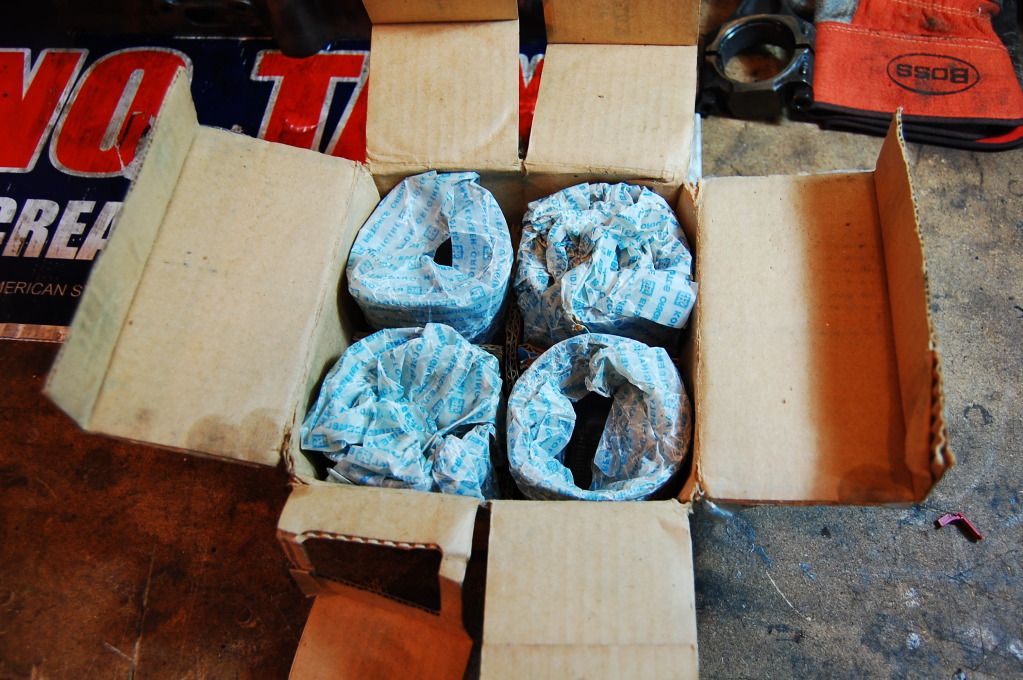

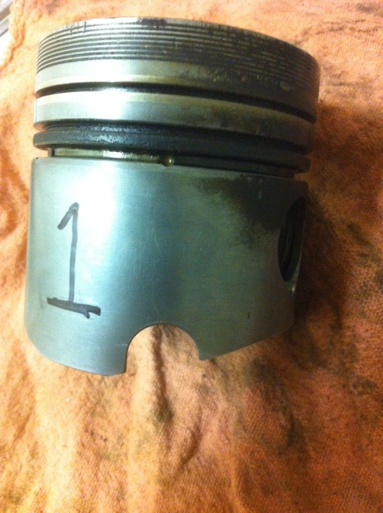

At the same time, I'm working on the engine combination. This will be a 1.5L rotating assembly in a 1.6 TurboDiesel block.  It's kind of like building a 327 or 302 Chevy from a 350 block.  If you have the right crank, rods, and pistons, all the geometry works out. In order to build a sub-1.5L diesel in a 1.6L "turbo" VW block, notches need to be milled into the 1.5 piston skirts for oil squirter clearance.  The turbo blocks have under-piston oil squirters which are not present in any of the naturally aspirated diesel blocks.  This first photo is a test notch that I milled into one of the old pistons for practice.
After milling the notch, and re-assembling the #1 piston and rod, re-installing the oil squirter, and rolling the crank over, I could tell that I need another 0.050" or so of clearance.   That machining change will be put into place for the "real" pistons, which are a set of NOS Kolbenschmidts, 0.5mm oversized for a 1.5L VW diesel.  These pistons are rare, but not unobtanium rare.  Good stuff comes in old, slightly ragged boxes.
These pistons have what may appear to be valve reliefs in their top surfaces.  However, these small pockets are actually part of the diesel injection chamber design.
Lastly, for now, here's a photo of the 4 lovelies, with the notch locations roughly marked.  These marks are not intended to be a precise outline of the machining, only to show me the correct rough location for the cut.  (Kind of like going into surgery and marking one's leg "cut here").  The blue tape is to proect the ring grooves and rings from getting any aluminum chips stuck.  These pistons have the entire ring package already installed.

I just recently finished re-fabbing the inner wheelwells on the front of this thing.  Cancer had infected it pretty badly, but she's solid now.  I used 16 ga. sheet metal for almost all of the patches.   The section between the subframe rail and the rocker is 1/8".  What remains of the factory floorpans is under these pieces.
This is one of the rear corners of the "cab", showing where a lot more rust was cut out, and fresh 16 ga welded in.
Inside view of the rear cab area, again showing the 16 ga floor panels.  I will weld some 1/8" steel over the top of this 16 ga, then weld the 1/4" roll cage attachment points to the top of the 1/8".
Front portion of the cab floor, with all the new metal welded in.  Again, what remains of the original floorpan is hidden under all the fresh new steel.
