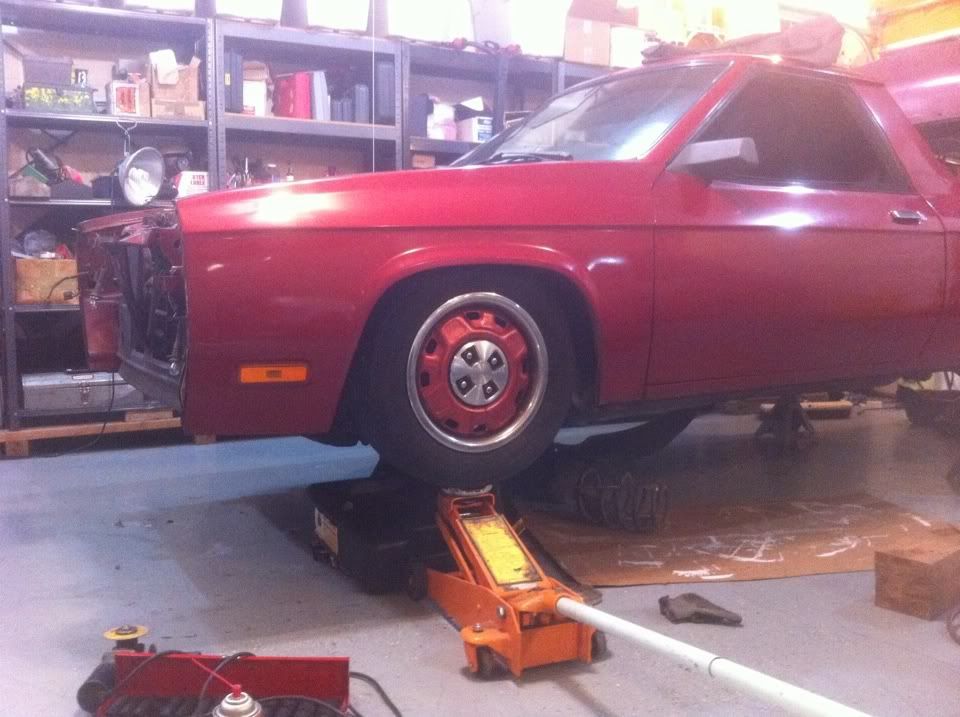

OK, let's see if I can successfully post photos.  This is what she looked like when I brought her home. Pretty much stock, with the exception of some tacky looking flames and a pretty decent tint job. The outer sheet metal looks good, with almost no rust. However, these things are known for rust in the front footwells. They tend to get leaks at the bottom of the windshield frames, which keeps the carpets wet. Back in '86, my '80 was already rusted through in the floorboards. This one is going to get "subframe" connectors and a full cage, so the rust in the floors won't be too much of a concern. It's all going to be fabbed in. After I got it in the garage and started pulling it apart, I couldn't resist the urge to see how low I'll be able to get the front suspension. There is a pretty good wealth of knowledge about these cars/trucks. It's the same platform as an Omni/Horizon/O24/TC3/Turismo/Charger/Scamp. The "hot" setup for the front suspension is a swap from a later model Neon. There are a lot of coil-over and air suspension options for the Neon suspension. Anyway, this is what I'm aiming for in terms of ride height for the front end.  Let's see if I posted the photos right before getting any deeper. Steve

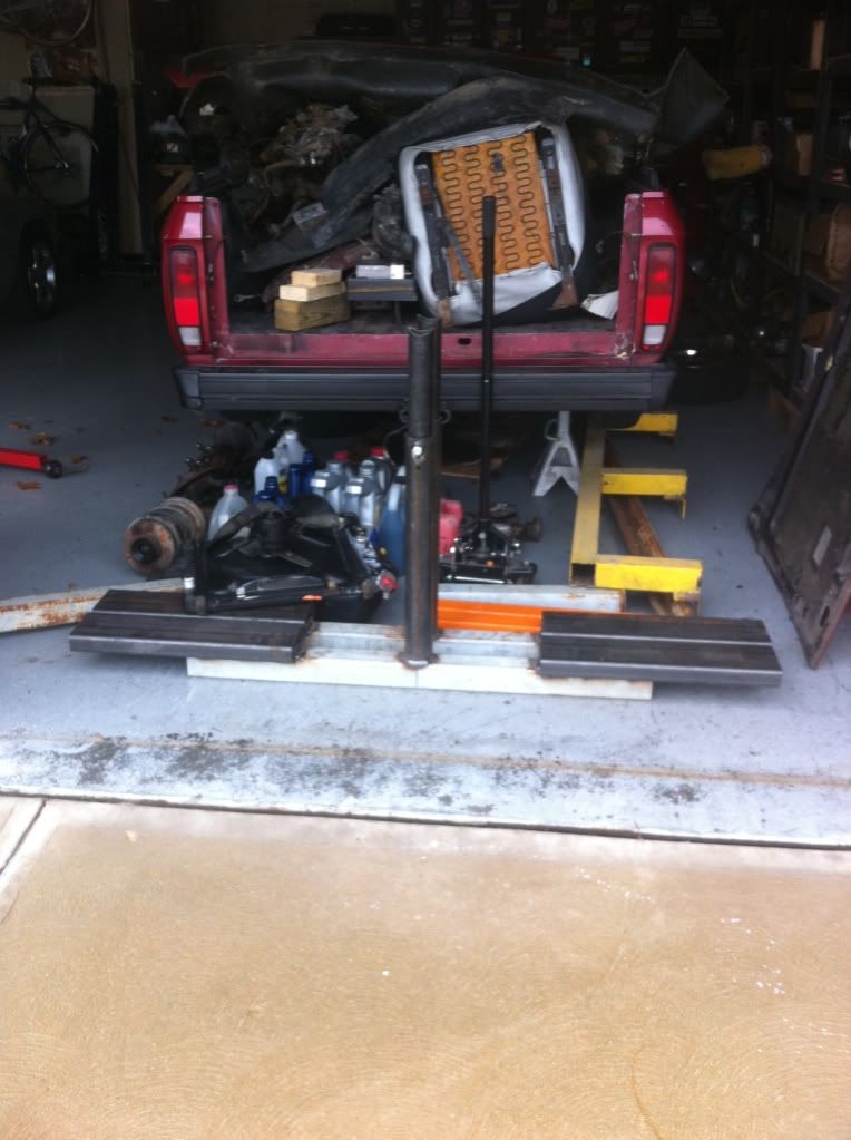

A few more pics for now - all taken from my camera phone. I'll have some better pics loaded later, taken with more of a "real" camera, but these are not bad considering they came from my phone.  Just in case anyone was wondering what an '84 Rampage looks like with the nose and hood removed. I've started labeling the wiring harness so that I'll know what's what at a later date.  Here it is, stripped down a little further. The engine, trans, and most of the front suspension have been removed, along with the fenders and doors (those doors are a PITA to remove, the hinges are welded on, instead of being bolted). The hinges contain 1/4" roll pins which have to be driven out to remove the doors, and there is almost no room to get a punch and hammer in there. Anyway, they are out now. Next, the wiring harness, glass, and rear suspension will get pulled off. Then it will be ready to put onto the rotisserie (when the rotisserie is done).

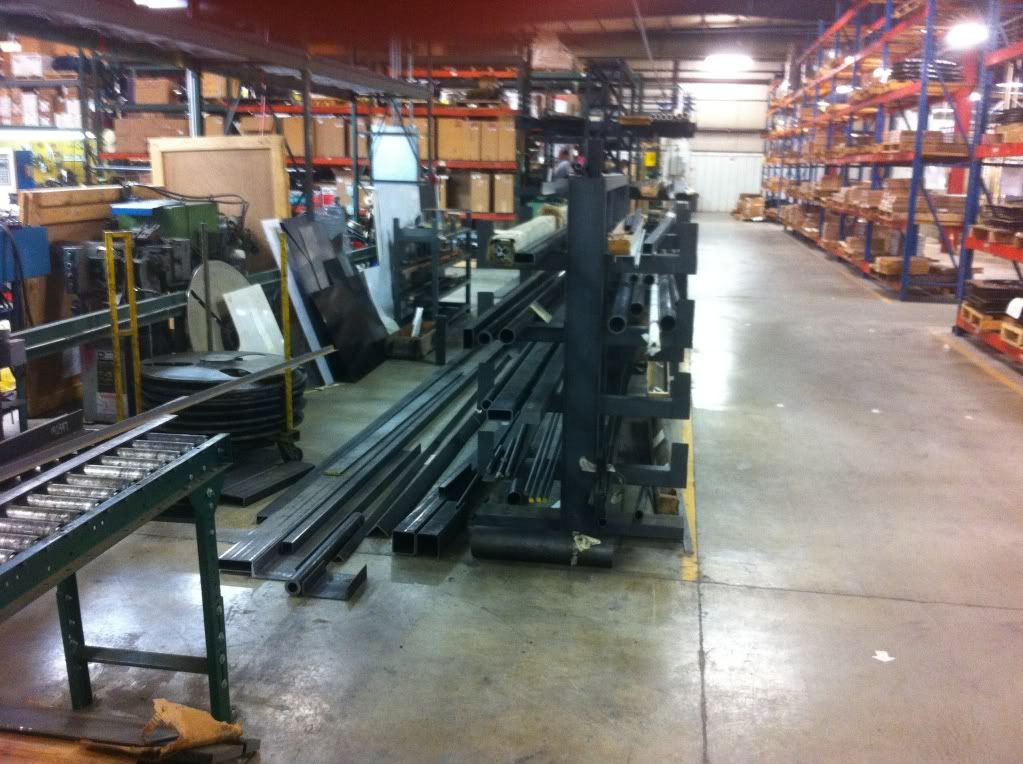

My day job includes managing a machine shop complete with all of the tools of the trade, Bridgeport, manual lathes, CNC milling equipment, CNC lathe, cut-off saws, bead-blasting, welding equipment, etc. Lack of tools will not hold me back. Lack of knowledge and expertise will be a bigger hurdle, but I fully intend to do all of the work myself. I'm sure there will be some things that I won't be able to do, but I haven't been able to see far enough ahead to figure out what they might be.

There is a good supply of knowledge here also. The M/C shop leadperson / supervisor campaigns a 410 inch sprint car and one of those 650 cc mini-sprint cars. He's a big time gear-head. I can tap into the machinist's knowledge base, but I still want to do all the hands-on work myself. Like I said - lack of equipment and materials will not hold me back. The lack of ability to keep my thumb away from the phone's camera might be a problem, though.

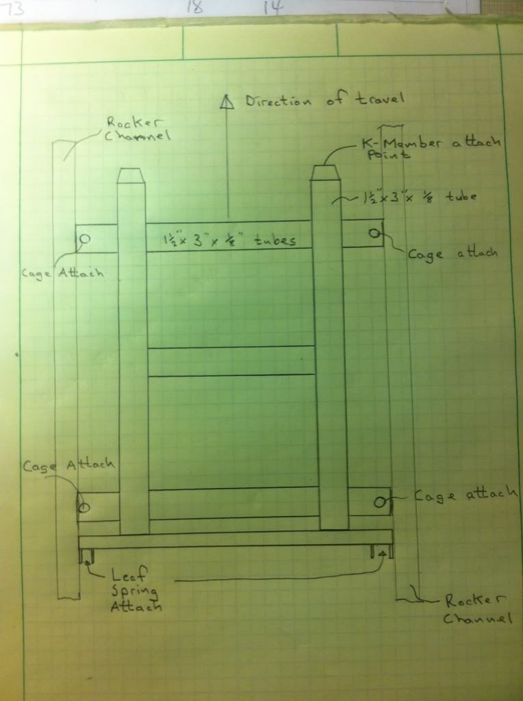

When I get the body rotisserized, I'll try to show a little better how I think the frame will work. The "horns" will be short sections (maybe 6" long or so) that will help to tie the unibody rocker panel rails to the rectangular tube ladder frame. I don't have a good way to post drawings at this point in time - hopefully I'll be able to figure out how to do so. At least in my mind, the horns will be an integral part of the fabricated frame and the unibody of the truck, tying the two together. I envision some cross-shaped support gussets that will tie the main frame rails into the supports that will tie the frame rails together, as well as tying the short horns to the main rails. The outer ends of the horns will tie into the rocker channels, probably with some 1/8" support plates. I think that this design will help to tie the entire cage and unibody together, but I'm definitely open for suggestions.

Here's a crude sketch of what I'm thinking about the frame / subframe connectors, and how the rails would be tied into the unibody structure. At the front, the rectangular tubing would tie into the front K-frame mounts on the Rampage. At the rear, the rectangular tubing would tie into the rear unibody "rails" at the location of the rear leaf springs. The short horns would tie into the main rails and to the rocker channels. There would be additional cross-pieces between the two frame rails, as shown.  I think there will have to be some tri-angulation and gussets involved as well. Please let me know if this looks like a reasonable plan. Steve.

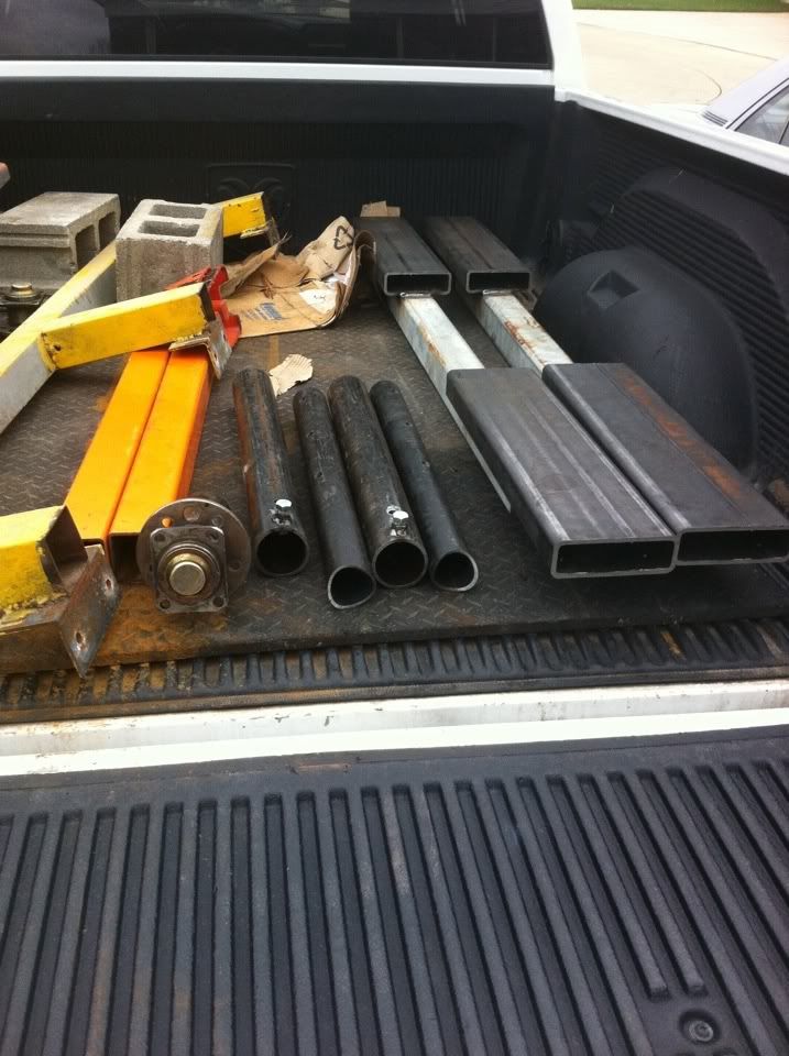

1 more pic, this time of more rotisserie parts. The 3" tubing with the "saddles" bolted on will be attached to the ends of the rotisserie. The saddles will be welded to the underside of the ends, and the 3" tubes will bolt to the saddles. This will allow it to break down into a smaller package after the rotisserie is done being used. The 2-1/2" tubes with all the holes will provide the vertical adjustment for the mounting points to the body (to get the center of gravity right for rotational purposes). The 5" tubing with the holes and bolts will be fitted to some Neon stub axles, which will allow the entire body to rotate. The shorter piece of 3" tubing in the foreground will tie together the 2 long pieces of 2-1/2" tubing that will join the 2 ends, underneath the truck's body. I realize that these may not be the most interesting photos, but this is where I'm at in the build.
