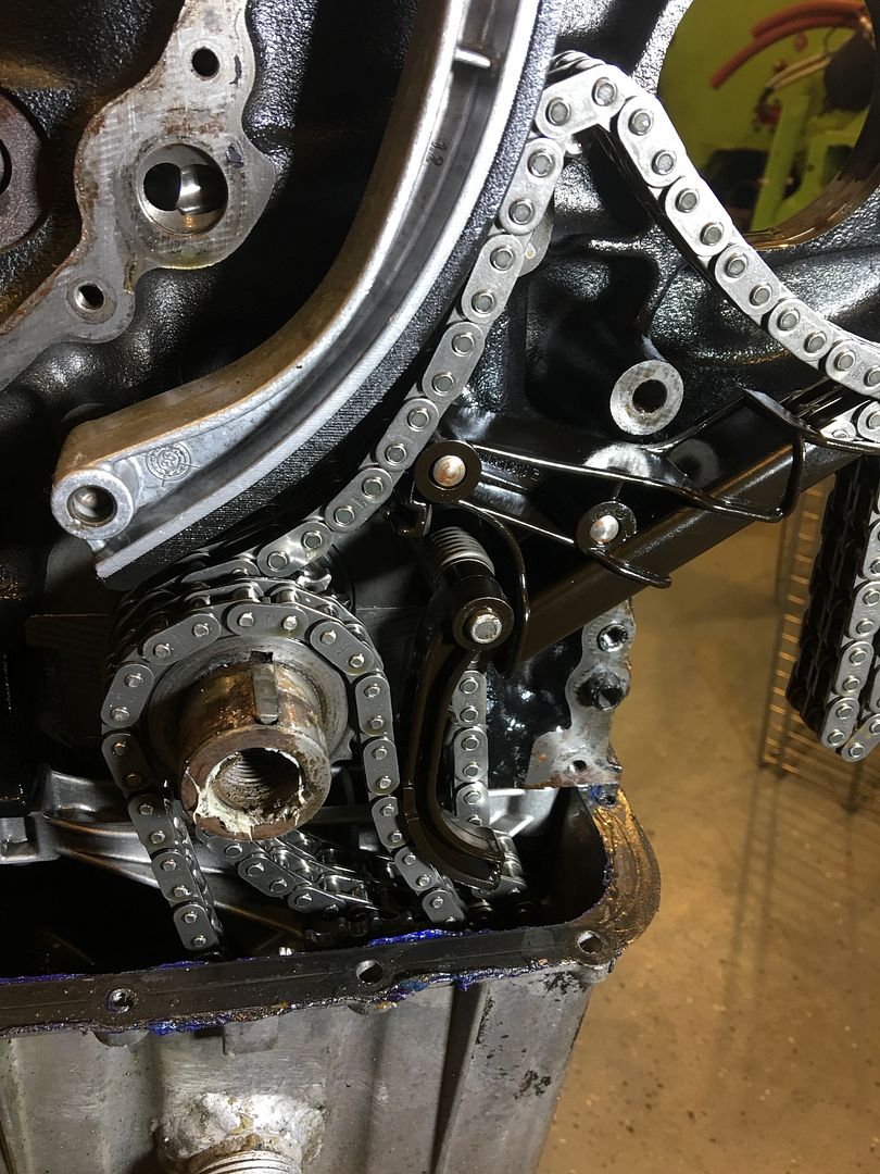

All Righty then....  back to work on the Rampage, pulling the 2 liter engine apart to see what needs to be done for 2018.
Most of this Mercedes engine is pretty typical, although it does have a few particular "Mercedes" features, like this rotary camplate on the front of the injection pump drive sprocket:
In this case, the bad news is shown in the roller bearing follower that is driven by that camplate (this bearing looks BAD):
For those of you who might not know, MB is fond of chain drives and sliding tensioners:
The last sad picture for now is this milkshake which was drained out of the oil pan:

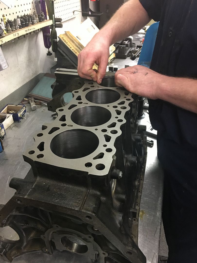

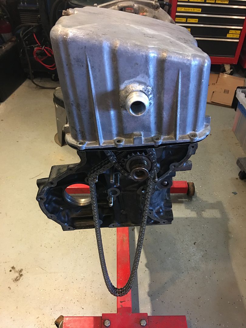

All righty then.... a little more disassembly took place, and I'm ready to drop off the block at AMT Racing engines for a thorough cleaining, magnaflux inspection, and having the deck of the block machined the absolute minimum amount to clean up the surface finish.
Rods and pistons are ready for another round in 2018.
I "think" the block is fine, except for the very rough surface finish on the top deck surface.

The block has been decked, the cylinders have been straightened out, pistons have been sent out for high-tech coating, and the piston rings have been checked for fit.
Everything is looking good (much better than the non-flat, super rough deck, tapered bores, etc) from the original "machine work" performed by a previous shop.
The plan is to focus, focus, focus on this 2 liter effort for Bonneville this summer.

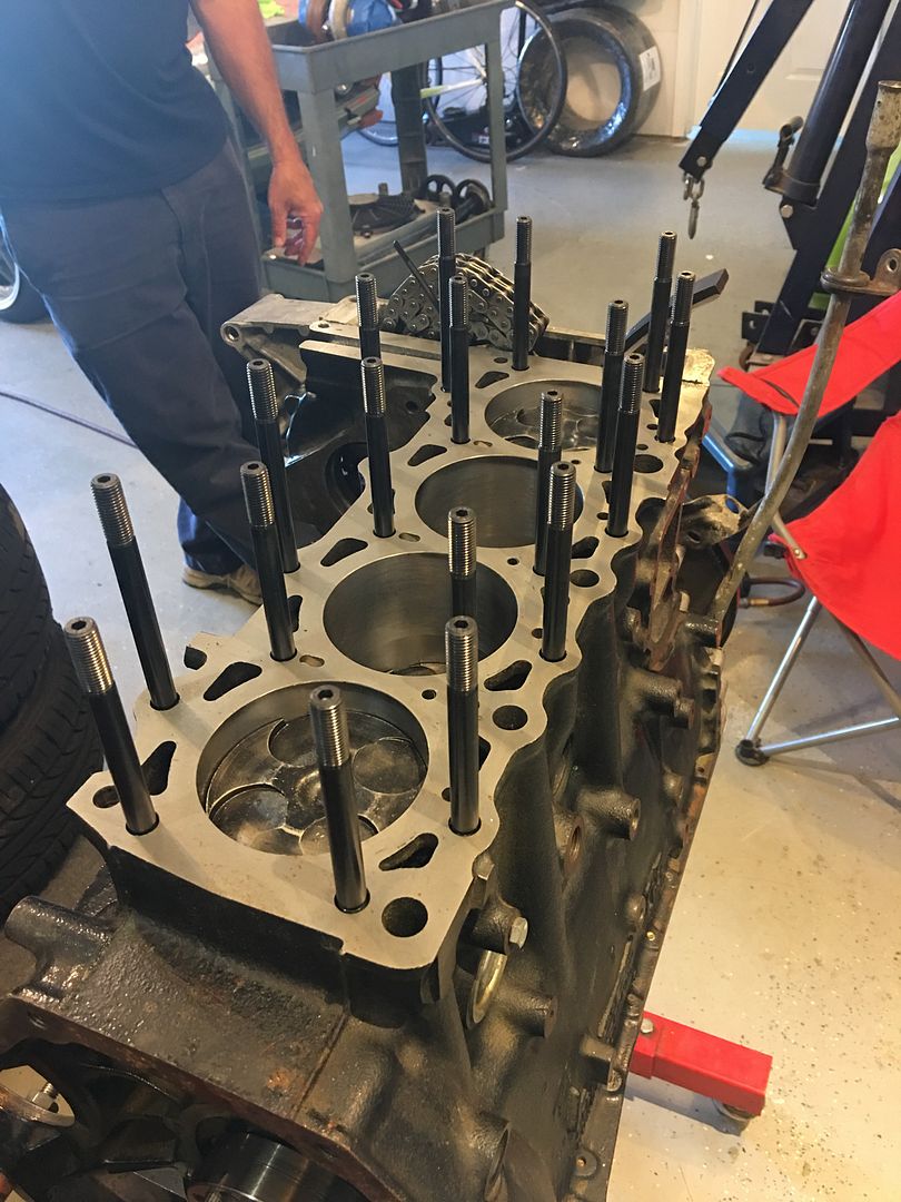

« Reply #1604 on: May 29, 2018, 03:46:35 PM »
Good eye on those bolts, Sid.  They are definitely an odd duck.  While not true "torque to yield", there is an overall length tolerance for them.  Mine were within spec, but after your comment, I decided that it was better to be safe than sorry.
A call to ARP to check availability of main studs with M11 x 1.5 pitch threads revealed a set intended for Chrysler 2.2L engines fit the bill.....
These studs will be nice insurance for peace of mind, if nothing else....
