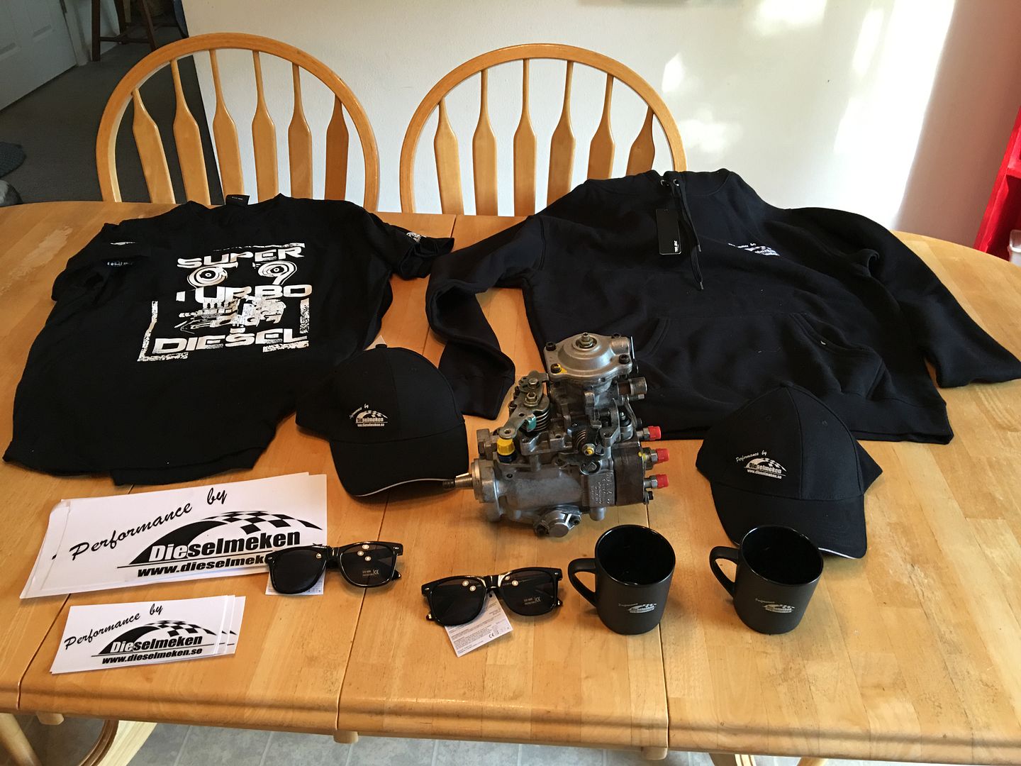

More updates.....
I received a package from Goran Lindgren (Dieselmeken.se), which included a freshly tuned, re-curved injection pump for my 1.5 engine, along with a whole bunch of Dieselmeken swag (t-shirts, decals, hoodie, coffee cups, sunglasses, hats)....
I can now be fully decked out from head to toe in Dieselmeken accoutrement.

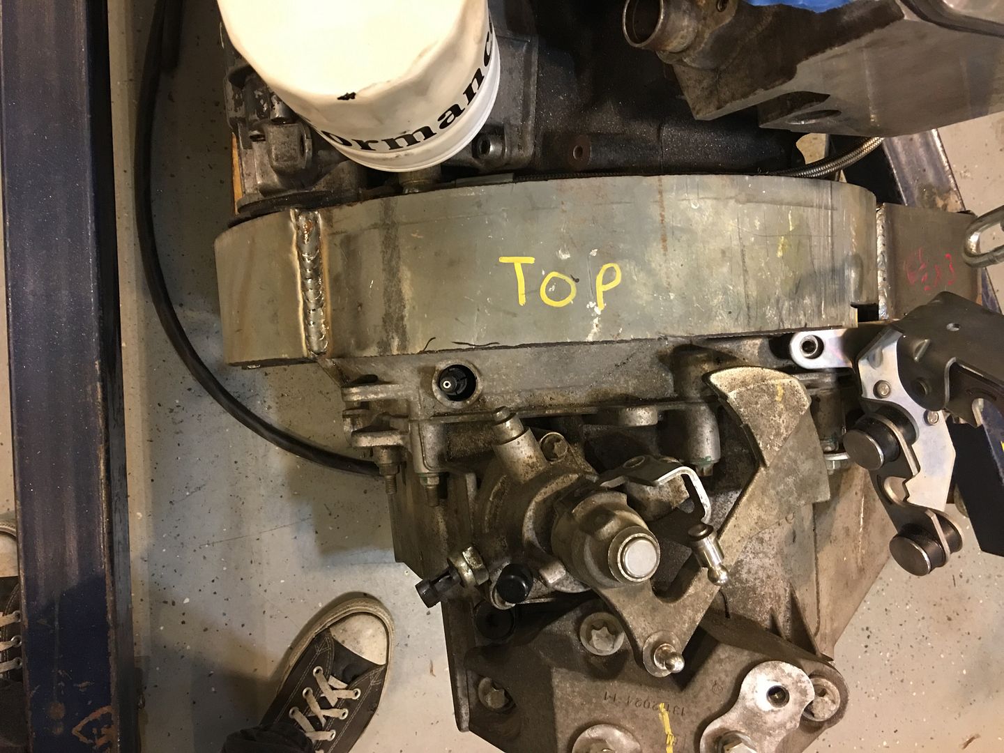

Then, on to the serious work of the day, which involved fabricating a scattershield for the 2 liter / 6 speed combo.  If this part of the scattershield is pointed towards the ground, then the entire vehicle is most likely upside down....

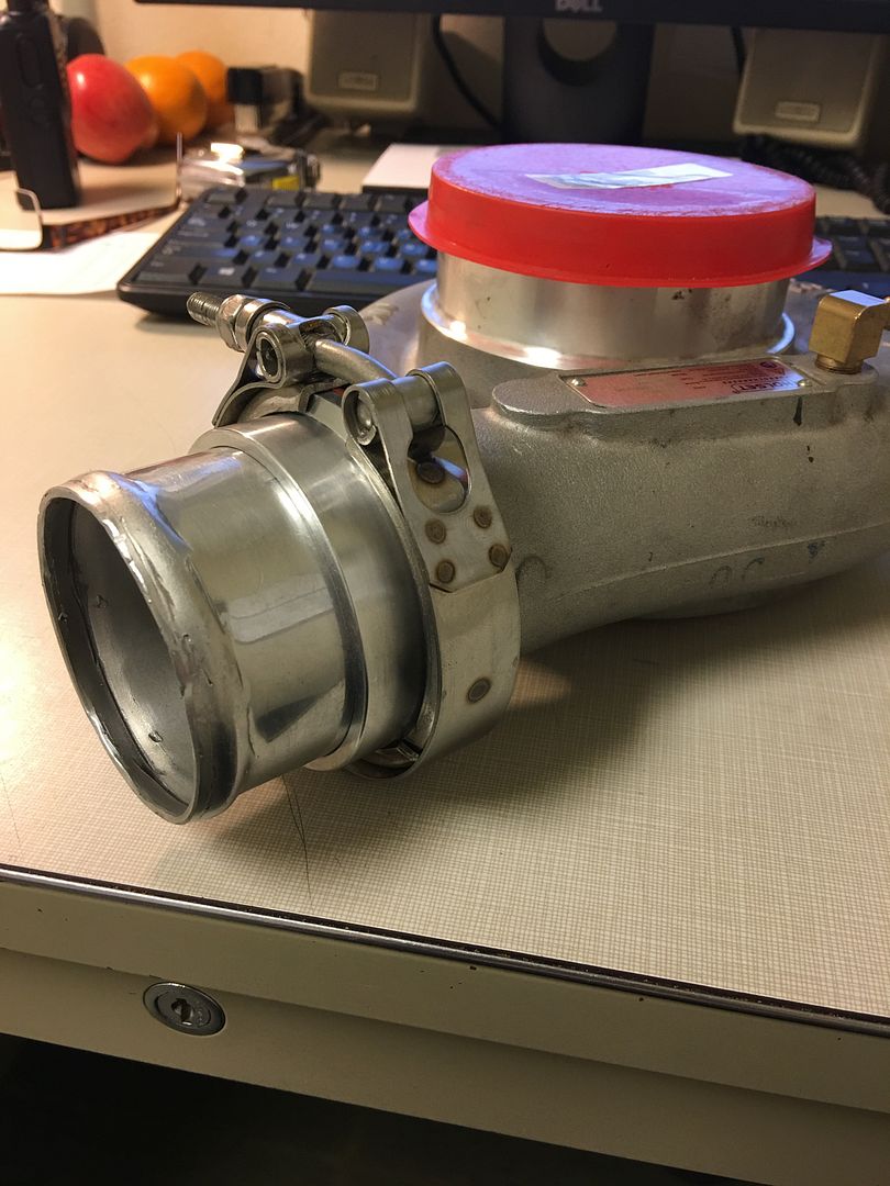

and last but certainly not least, I started trying to figure out how to get the turbo outlet fittings to work in combination with the turbo housing...
With a little bit of TIG welding, I think this setup will work just fine!

Progress continued last night, and 2 friends and I completed additional fabrication work on the scattershield, as well as bleeding the clutch slave cylinder / throwout bearing, installing the clutch and PP, and bolting the engine to the trans.
