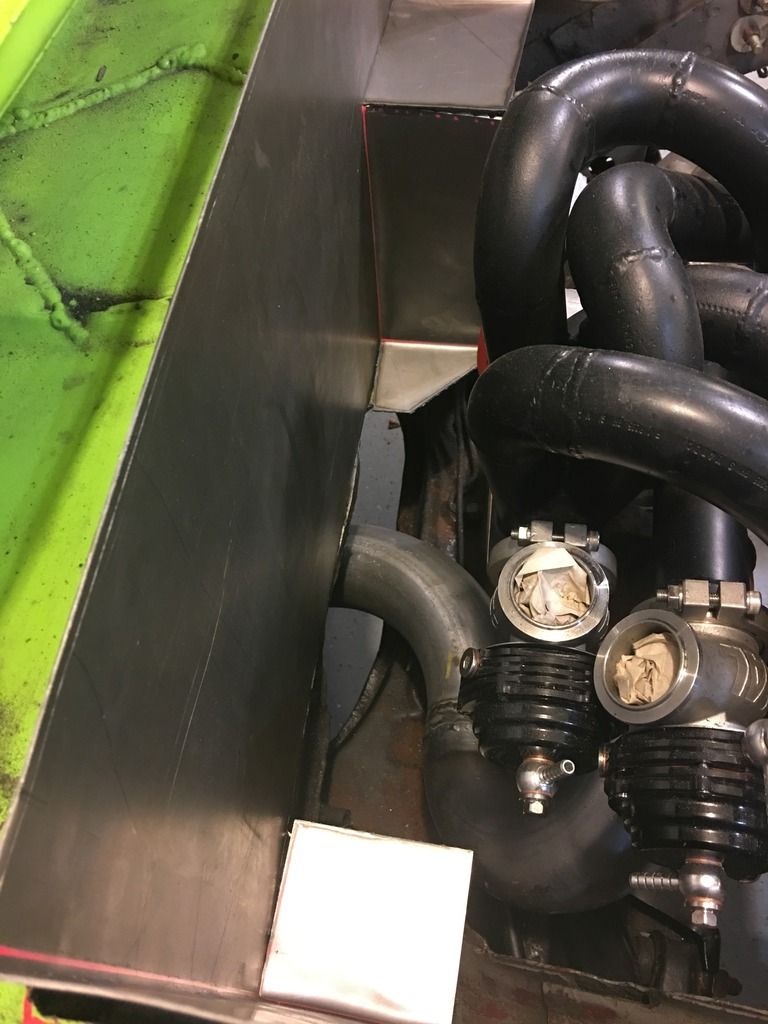

Last night's progress - working on the wastegate dump pipes.
The details may seem mundane, but posting helps keep me motivated.
First - I had to set up my "pipe stretching" apparatus:
Then, fire up the TIG machine and get some much needed practice....
Then, to do that activity that always hurts - cutting holes in otherwise good sheet metal.  I would have preferred to avoid damaging a "Performance by Dieselmeken" decal, but some sacrifices must be made to the gods of speed:
I'll need to make an escutcheon-type plate and trim the pipes off, but this will be the general layout for the wastegate pipes.

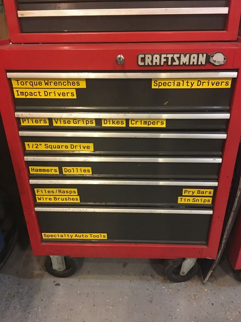

First of all - infrastructure and organization are important.  To that end, I have started labeling the drawers of my tool chests.  This is not so much to benefit me, but to benefit anyone who may be foolish enough to stop by and help work on my project...
Next up, since SCTA would not approve my waiver for a cardboard firewall, I went ahead with the plan to make one from 0.062" thick steel.

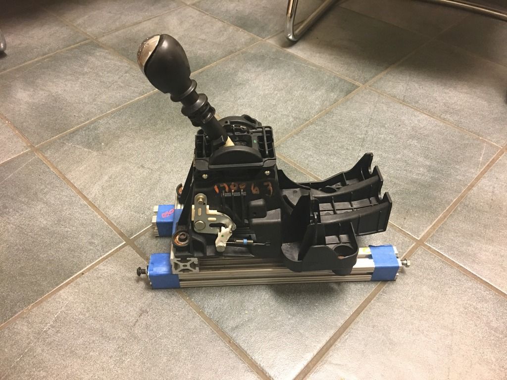

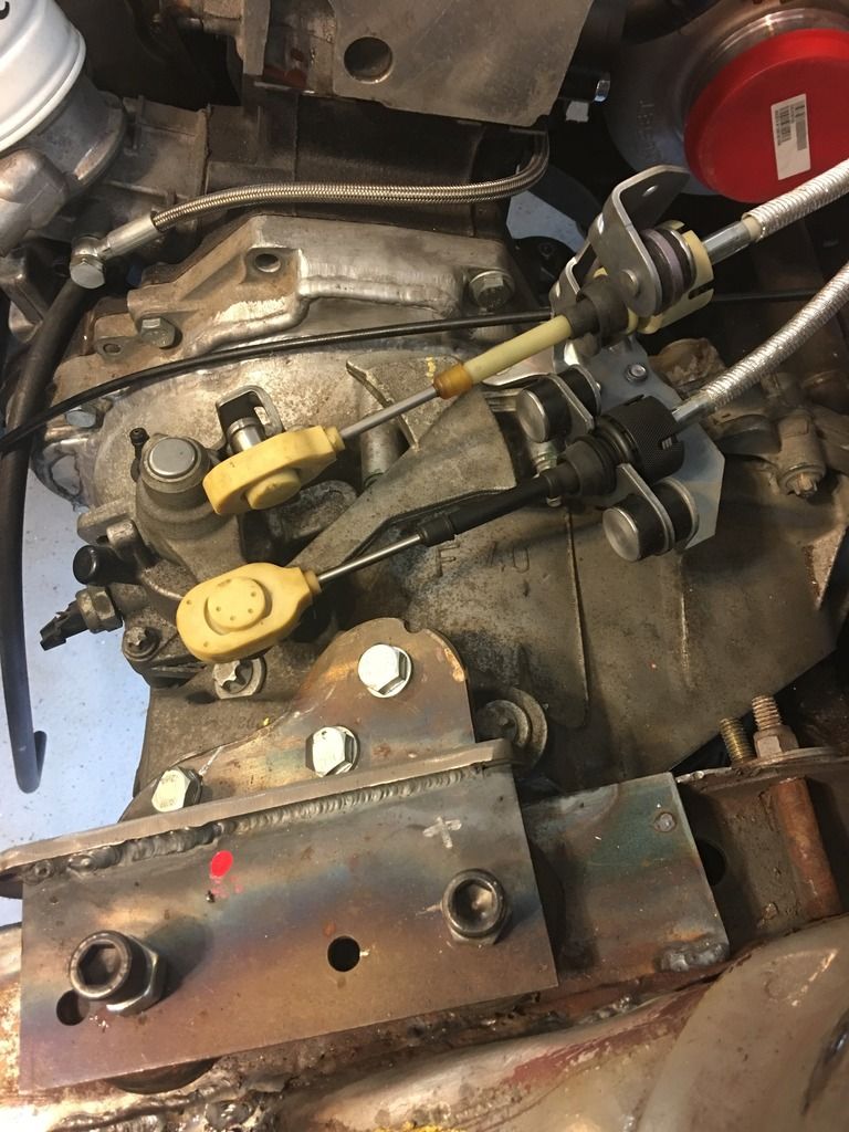

and I managed to "score" a set of discontinued shift cables for a 2006 Pontiac G6 GTP (6-speed) car.  These are discontinued parts from GM.
Lastly (for now), I built a shifter mounting bracket from 80/20 extruded aluminum channel.  This should allow me to change from the Mercedes/Saab/6-speed setup back to the VW/VW 5-speed setup with relative ease.

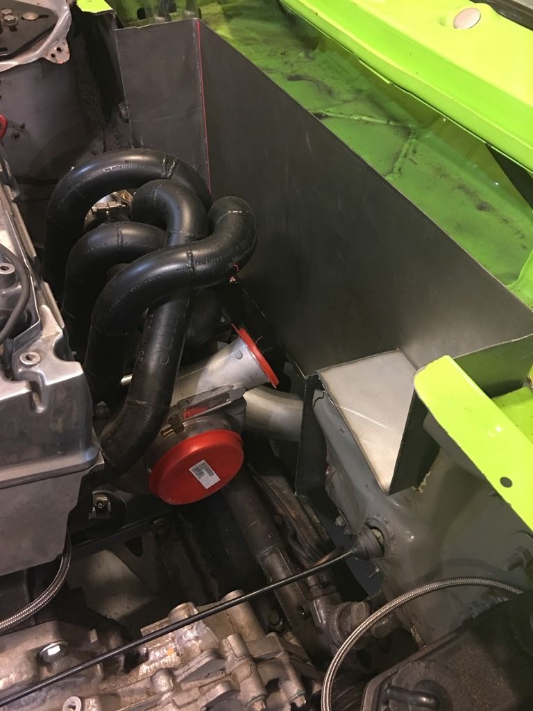

Just to keep the documentation up to date - I spent most of the weekend cutting, grinding, and welding in the engine compartment of the Rampage.
I have boxed the Lee Iacocca era "frame rails", C-notched those rails for clearance at the transmission and for the water neck outlet on front of the Mercedes engine, have the steel firewall welded in, and have constructed a heavy-duty tubular steel upper radiator core support to help keep the nose of the truck from flexing backwards, while supporting the upper radiator mounts as well...
