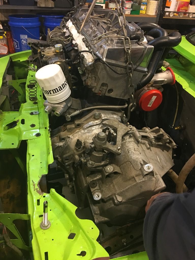

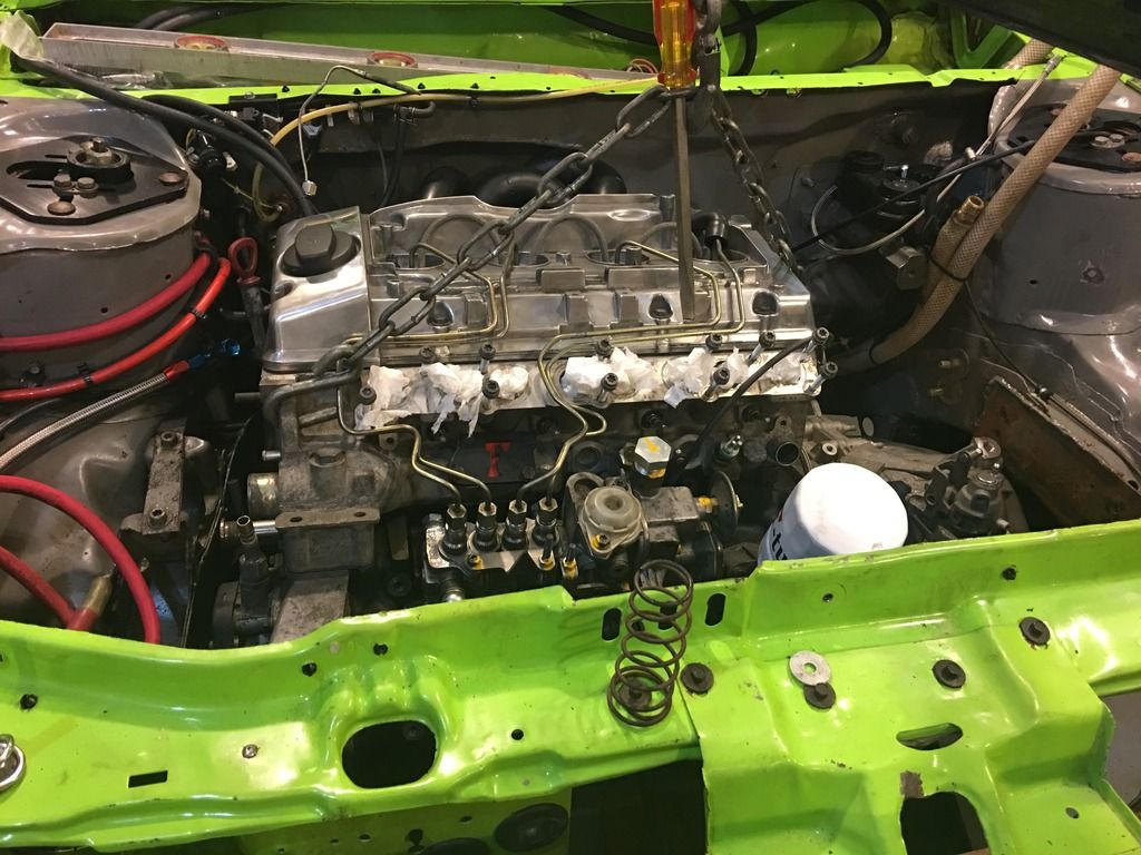

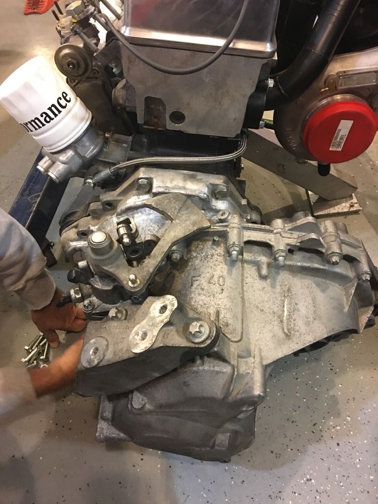

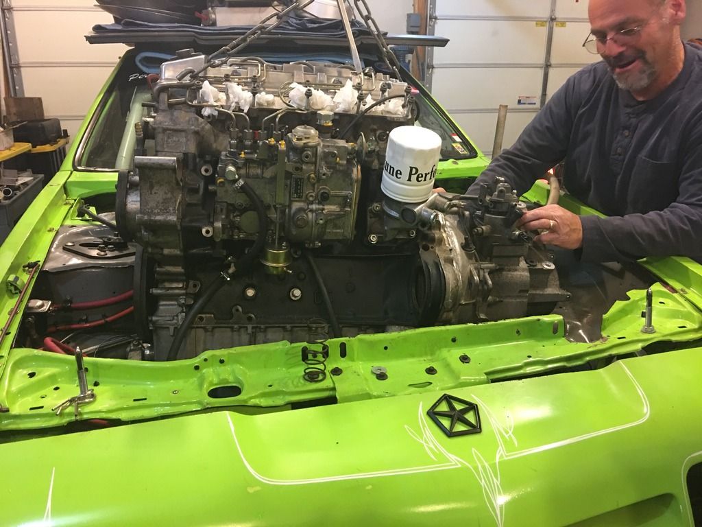

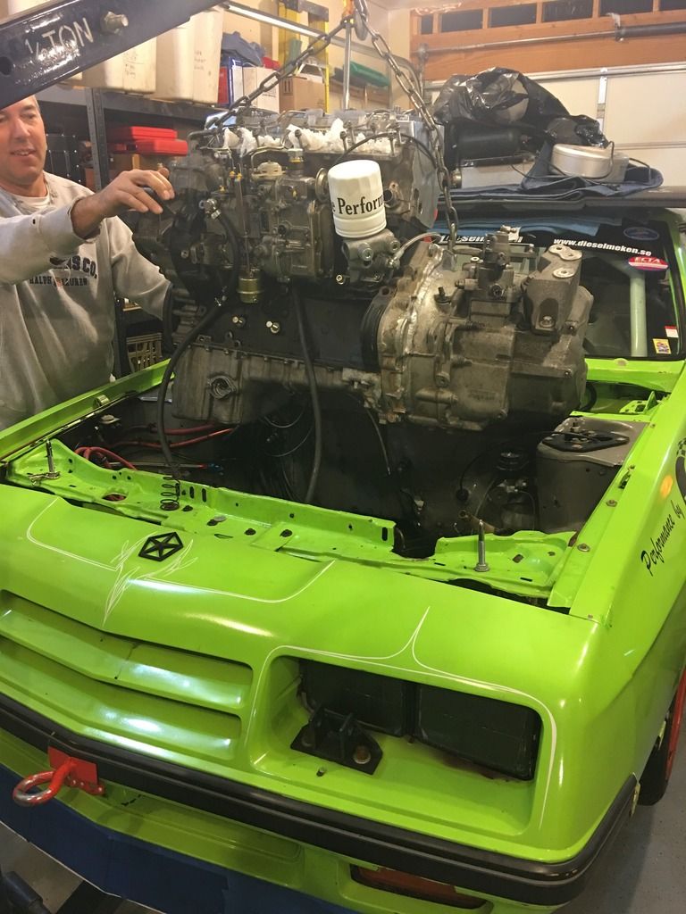

« Reply #1479 on: November 22, 2016, 09:35:21 AM »
2 of my friends stopped by last night to help with test fitting of the new engine & trans into the Rampage.  I'll try to tell the story with captioned photos:
Step 1 - bolt these two parts together:
Step 2 - OK, done.  This looks bigger and heavier than the VW drivetrain we were using before....
Step 3 - Yeah, it's definitely bigger....
Step 4 - I think it's going to hit....
Step 5 - Hit what?  Hit everything....
Step 6 - Nahhhh, it will go....
Step 7 - Are you sure?  Yeah, I'm pretty sure....
Step 8 - All right, Man, looks pretty good....

« Reply #1480 on: November 22, 2016, 10:31:56 AM »
You got it in sideways.  How're you going to attach it to the rear end?
Past Member of the San Berdoo Roadsters -- "California's Most-Exclusive Roadster Club" -- Fifty-Seven Years of Leadership  Is Enough
  • Posts: 12661
« Reply #1481 on: November 22, 2016, 10:35:09 AM »
How 'bout a long flexy cable, Stan?
  • Posts: 6484
  • Age: 60
  • Location: Beerhaven, Wisconsin
  • After further investigation, I/GT record holder
« Reply #1482 on: November 22, 2016, 10:38:55 AM »
It's a little long on one end, and a bit wide on one side.
I wear size 15 boots - can I loan you my shoehorn?
« Reply #1483 on: November 22, 2016, 02:07:34 PM »
Next up - carefully marking the firewall, welded-in transmission mount, and radiator core support before making some strategic cuts.
« Reply #1484 on: November 23, 2016, 09:06:12 AM »
Hoping to find some time to cut the firewall and "rain tray" back over the next few days.
