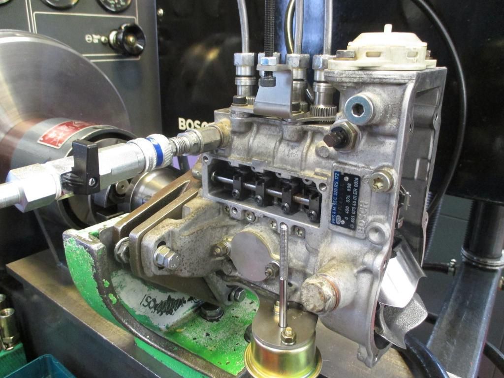

This is so exciting, I just have to share.  Here's a video of the injection pump for our G-glass engine, being run on a test bench.
In this video, the pump is running at the equivalent of 7,000 engine RPM, which is almost unheard of for a diesel.
Goran Lindgren (the Dieselmeken AB) is at the absolute pinnacle of the diesel performance world.

The G-class engine is also being worked on.  The video shown above is related to that engine, which will also be developed in "Stages".  For Stage 1, I'm looking for 400HP.  Keeping the other team members and partners on-board with the "Stages" philosophy is important.  We don't want to shoot for the moon and end up breaking something early in the development.
On a re-test of the injection pump, Goran Lindgren (Dieselmeken AB) ran the re-worked pump at the equivalent of 8,000 engine RPM's for 3 minutes.  Unfortunately, that video is only posted on his FaceBook page.  If you want to see the video, you'll have to "friend" him on FB.

One last pic for now - this is the OM604 "Super Stroker" pump being built by Goran Lindgren, in Aneby, Sweden.
