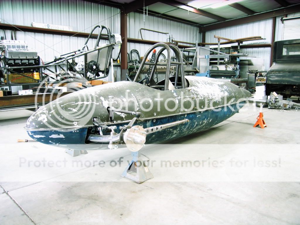

It's been busy in the shop lately, but I have made some progress on the tank.  here's where i am at:
The rollcage is tacked up and the shell is trimmed out for the cockpit.  You can also see the
wooden buck for the aluminum headrest fairing (in progress)

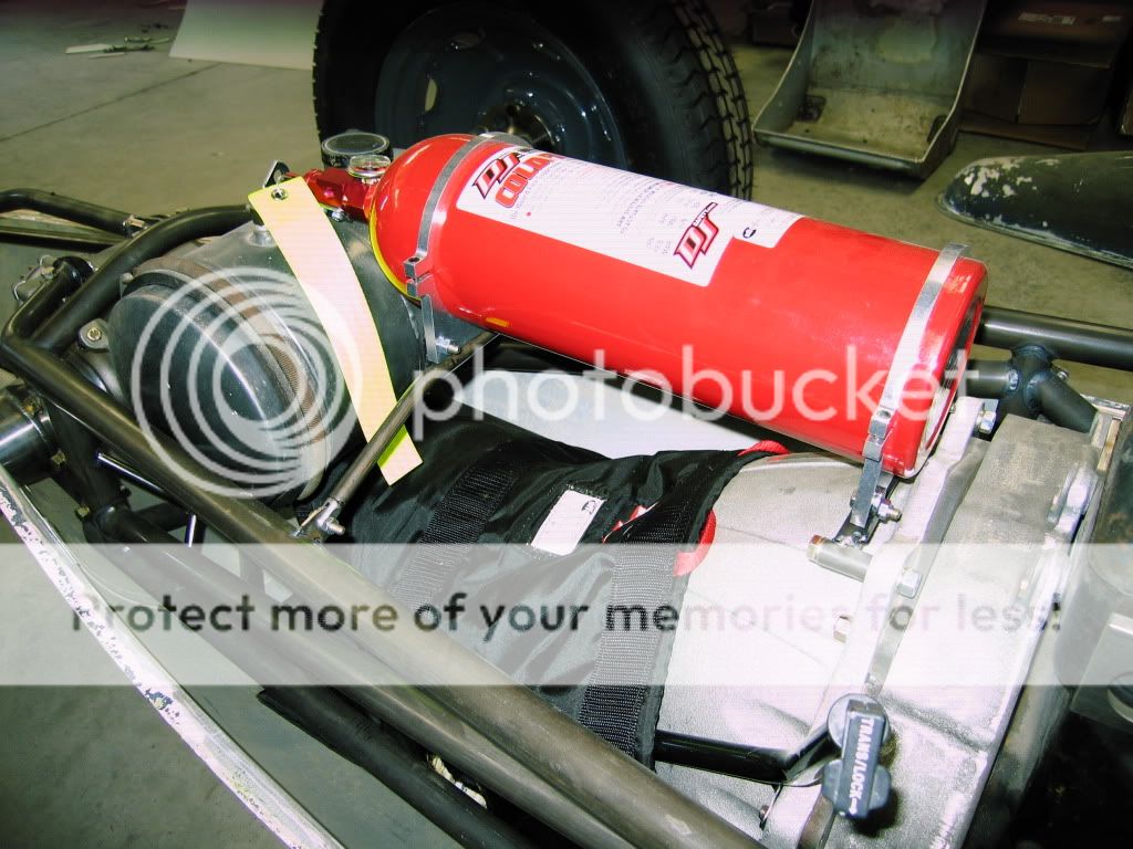

Scott found the vintage Moon fuel tank, which fit perfectly over the tailshaft.  The firebottle
came from DJ Safety.  There has been some talk of doing a dry sump on the banger.  If we do,
I think we can fit an oil tank under the firebottle.

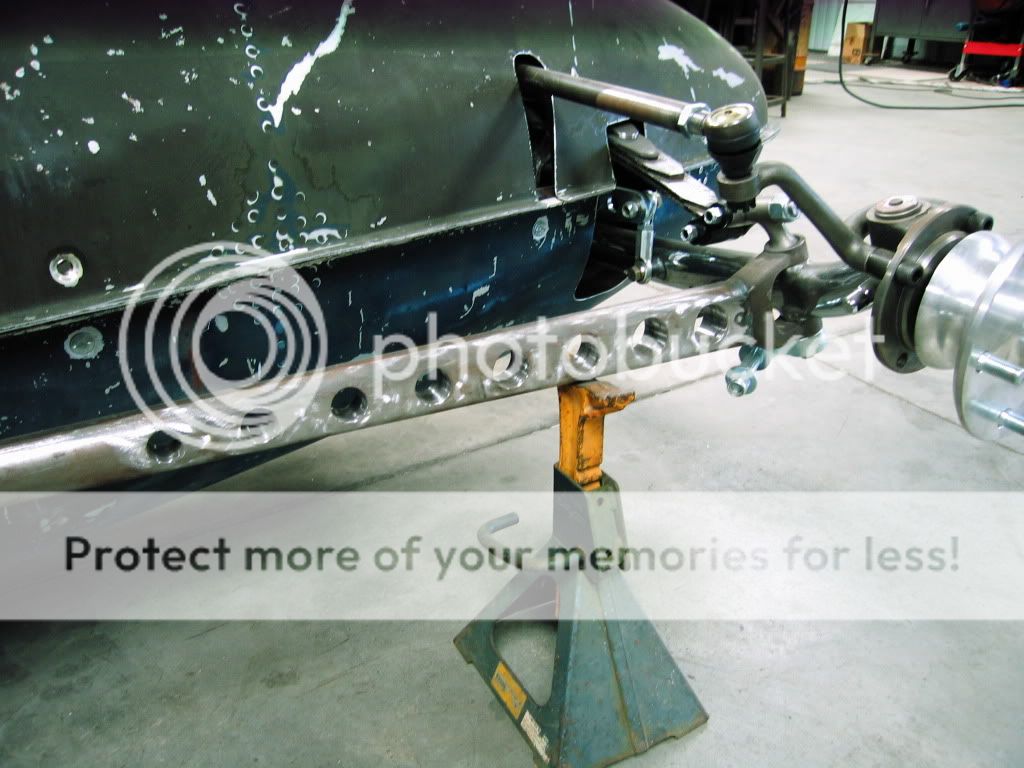

I built the push bar on quick pins so it can fold up and out of the way to
change gears.

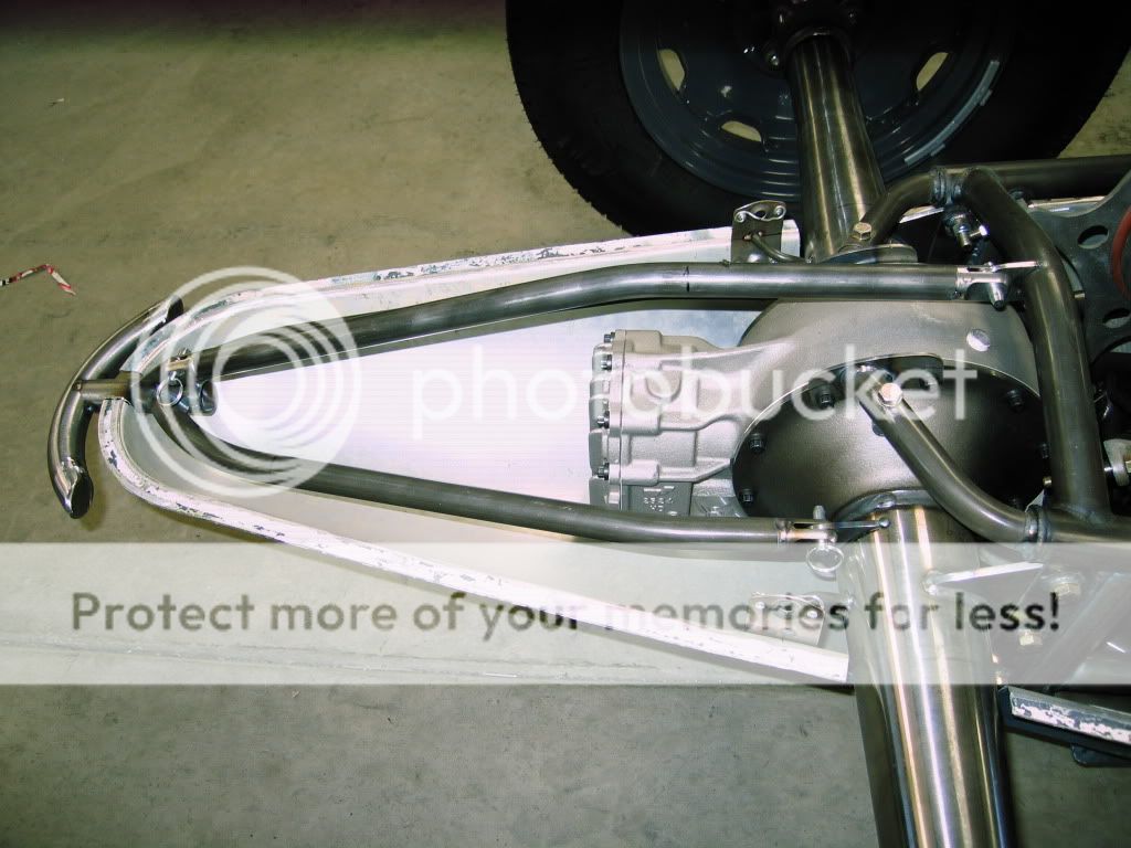

I filled the holes in the split 'bones with tubing
