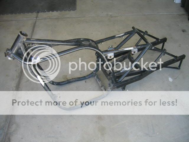

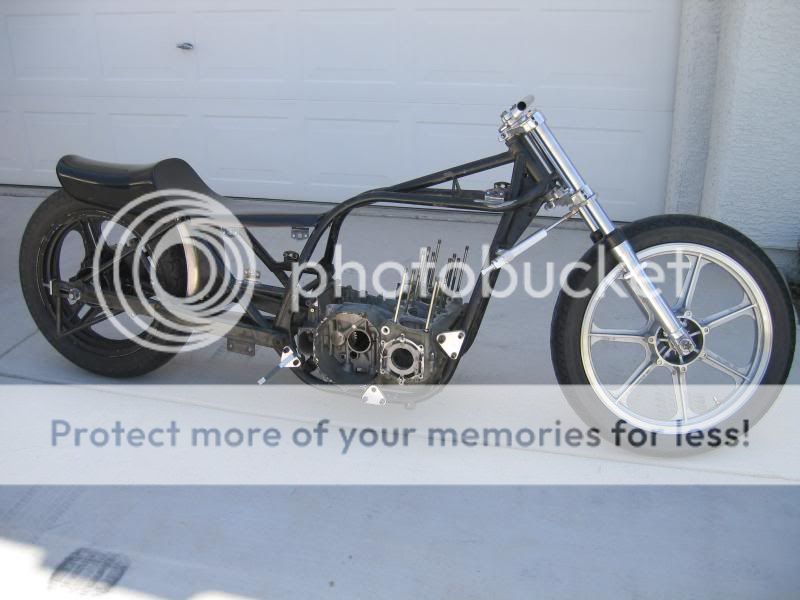

Since 1988 Iíve been using the Kawasaki Z1/KZ 900 and 1000 engines as the base power plants for my drag bikes.   I have a very old and worn Kawasaki drag bike frame setting beside the house and a lot of spare 900 and 1000 engine parts in the garage. I decide to update the frame and build a normally aspirated 998cc Kawasaki four cylinder engine to run in the 1000cc A/G class at El Mirage. Since the majority of parts for this project will be recycled from previous race bikes, ie left over parts,  Iím hoping to keep my project build cost under $2,500.00.
For a bike built with recycled parts and a $2,500.00 budget I donít expect to set any records or wow any fellow racers. I just want to see what the bike will do and whether Iíll successful at riding it to its full ability on the dirt.  Iíll just have to live with the power and speed it produces. Besides I shouldnít be thinking about records or 200 mph speeds as a rookie in this type of racing. I figure that regardless of the lack of horsepower the older style KZ  engine makes, that eventually I should be able to get up to 150 mph, and on the dirt with a ridged frame that should offer a little excitementÖ

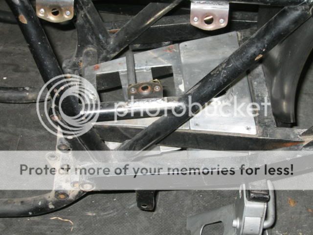

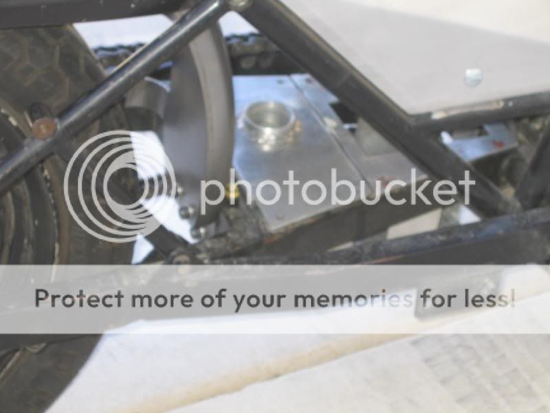

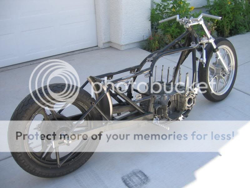

Iím going to use a stock Kawasaki GPZ750 rear wheel, 18X3, and a stock Kawasaki GPZ1100 rear rotor and caliper on the bike. Spacers need to be fabricated for the rear wheel as well as a rear caliper torque arm. Iím going to run a 26 inch tall tire on the rear to help with the gearing I want to run as well as adding a bit of additional rotating weight to help absorb some of the engine pulses and smooth out the power delivery.
I discovered that the front wheel I was going to use was not legal so now Iím going to use a 2004 Kawasaki Vulcan front wheel, 2X19. I had to fabricate front wheel spacers so the Vulcan wheel would set correctly in the Betor front forks.

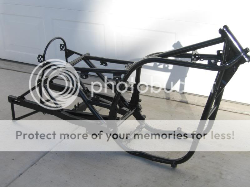

So the old frame is sand blasted, all of the old welds inspected, new gussets added, seat mount modified, rear inner fender added, one additional steering damper mount added, fuel tank and battery box mounts redone, rear brake stay arm mount added and zeus fasteners tabs welded on for the aluminum body panels.  Frame is painted and Iím ready to assemble the rolling chassis.
Itís taken me four months to get to this point. I only get to work on the bike about 6 hours a week, in a good week.
