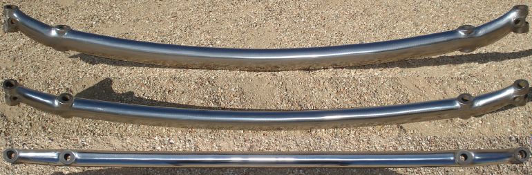

That's really neat. I'd love to build one too, if a decent P-38 tank came along.
Looks like you have a '37 V8-60 axle, and you've been cleaning it up.
Here are three views of one I polished with abrasives a few years ago. I have another one that's almost finished.
Dave
