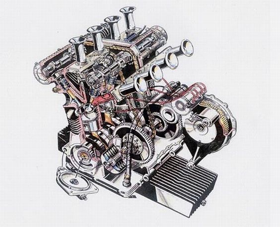

« Reply #12 on: September 23, 2017, 04:42:41 AM »
Hi,
This 2 ports/1 valve arrangement has been done at least twice in the sixties:
The URS 500 4 engine drawn/made/built by Helmut Fath for sidecar racing, he got a world championship with it:
That head (he also raced the std arrangement, 1 port/1 valve...) was inspired by Fath's visit to the French "Sorcier" Jean Nougier who built, amongst load of other things, a DOHC 50cc racer a few years earlier with the same arrangement:
Patrick
« Last Edit: September 23, 2017, 04:48:30 AM by thefrenchowl » Logged
Flat Head Forever
...What exactly are we trying to do here?...
Posts: 6802
« Reply #13 on: September 23, 2017, 08:53:57 PM »
Patrick.... I think the motor is 1 port and injector per valve, 2 intake valves per cylinder, so 2 injectors per cylinder.  The 2 exhaust valves share a common port.  Motor ran strong in the lakester....
