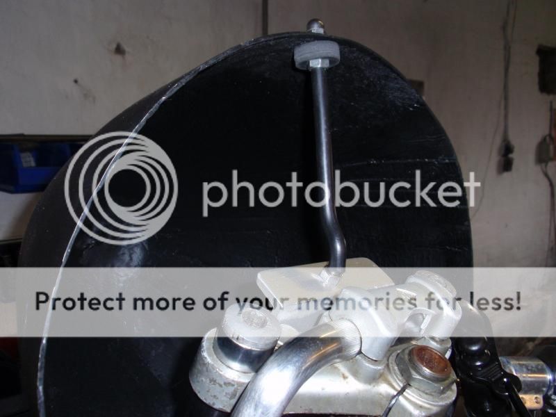

Finished mounting the fairing. Rulebook says at least 3 attachments, so that`s what it got. 2 bolts to the lower triple tree, and this, kind of rude, attachment at the top. Could have made it fancier, but this was the easiest, and makes the fairing very easy to remove in case of a class change.

Are both ends of your stay removable?
When we installed a Charlie Toy/AirTech fairing on my ZX12 I wanted to be able to take it off and run naked, too, so I used some stays to hold the windscreen/fairing top stable.  All was fine until I took off the top of the fairing - and noticed these two pieces of 5/16 rod sticking back and up at me from the nose of the bike.  I cut 'em near the bottom, drilled both the cut ends, and fitted a collar (holes drilled to match the ones in the rods) and secured with safety pins.  I expected that the inspectors wouldn't like it if I had two shishkebab skewers sticking out and pointing towards my shoulders when making a run.  It doesn't look all that pretty, but it does pass inspection.   smiley

D***! Yes it is, now I have to admit I lazied out and simply bent a piece of threaded rod rolleyes
4 bolts removed and both brackets and fairing comes off as a complete unit smiley

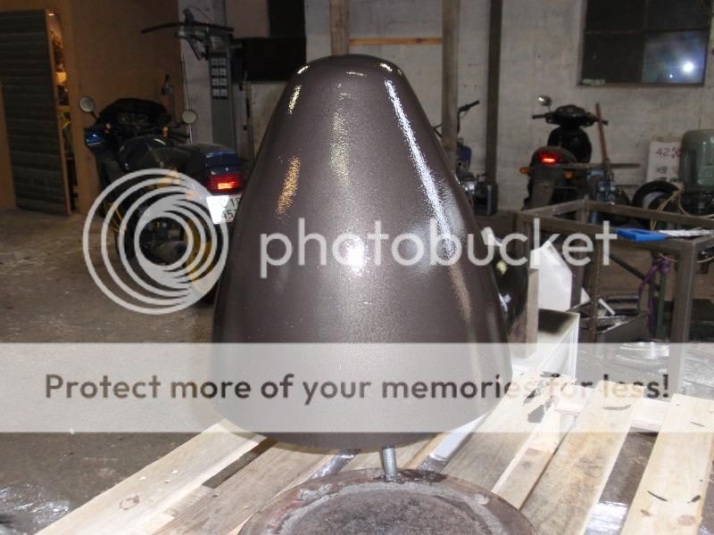

Todays work: A fresh coat of paint on tank and fairing
Used Hammerite metal paint because it`s simple to work with and pretty tough stuff.The hammered effect is probably not to everyones liking, but hey; who can argue against a paint that comes with built in "speed dimples"? grin

I sprayed this on, but with a decent spray gun, and not a rattlecan. Im not sure Hammerite wants you to do that. Have used the stuff for about 15 years, and there used to be instructions on how to spray it on the can, but those disappeared some years ago, and now it only says apply by brush or roll. Another peculiar thing is that is used to say it took a month to harden, now it says 4 hours. Guess they changed the formula smiley
You can get a fairly decent result with a brush, maybe not good enough for a tank, but pretty allright for a wheelhub or similar stuff smiley

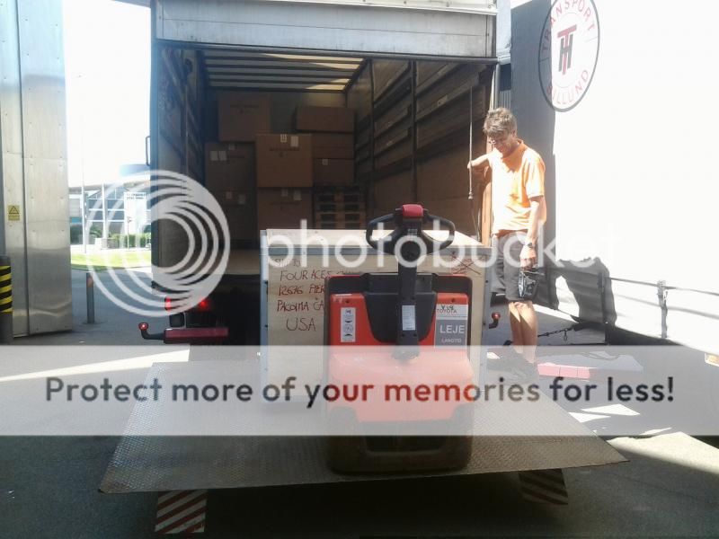

UPS finally came through with a decent offer. 1000$ shipping each way. On top of that comes 500$ worth of customs papers. Apparently some special papers are needed, to avoid paying import taxes going into the US and again when returning here. The UPS representative has been very helpful in explaining to me how it works, and they even offered to handle everything for 200$. An offer I definitely couldn`t refuse smiley
A big thank you, to all of you who have been helpful with advice regarding shipping, both here in the diary and through PM`s

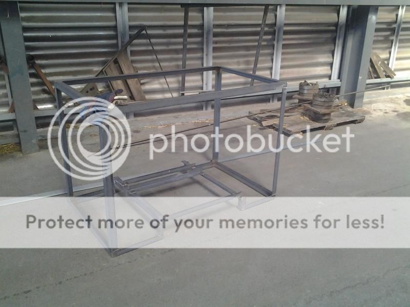

Time to build a shipping container:
The size of the frame pretty much dictated the shape of the box, that has to stay below 1 m3. Lenght and height of frame +roughly an inch is the same as the inside measurements of box, and width was adjusted to just stay below the 1 m3. Had hoped to be allowed to make a square box and put it on a pallet, but was told the size of the pallet would be added to the final measurements. That`s the reason for the "fork lift opening" in the bottom of the boxframe.
Finished box. Believe I have more hours in this thing than I have in my blower setup.
An unexpected problem was that Im not allowed to ship to a private person, but have to ship to a company.
Wes of Four Aces Cycle Supply, has very kindly agreed to receive the bike, and keep it until I come and pick it up cheers

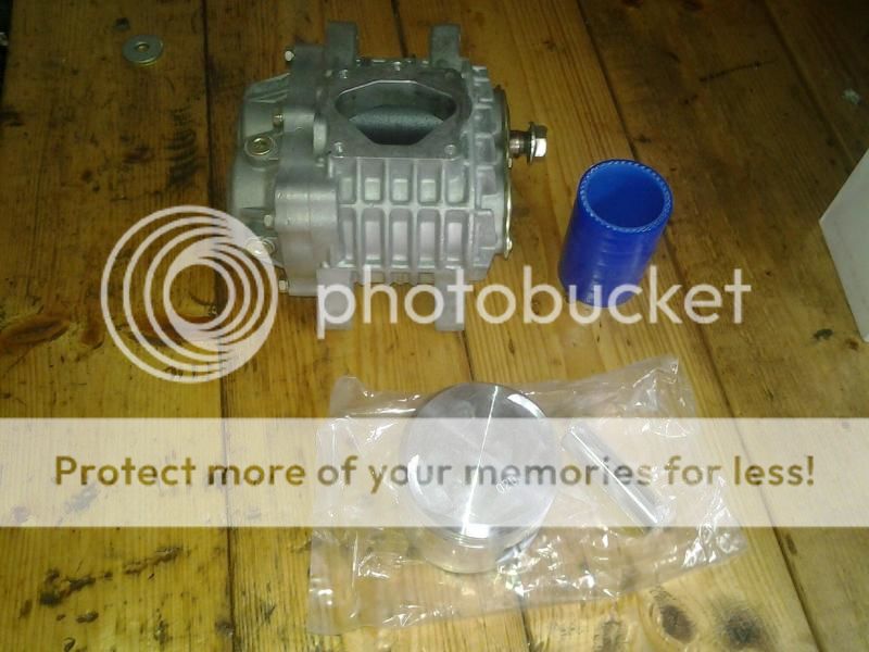

Had a few parts coming in to late to be packed in the crate, so they`ll have to go in the suitcase. A spare blower may be overdoing it, but made a good deal on a brand new one, and couldn`t resist. Hopefully it won`t be needed and will find a new home on a streetbike after SW. Also Bill is running a similar unit, and I suspect someone else may be running one also, so if I won`t need it, it could maybe save the day for someone else.
The new piston is a stock 6,5:1, as opposed to the 8,7 in there now. If the current one decides to give up, going down in compression may be a wise move smiley
